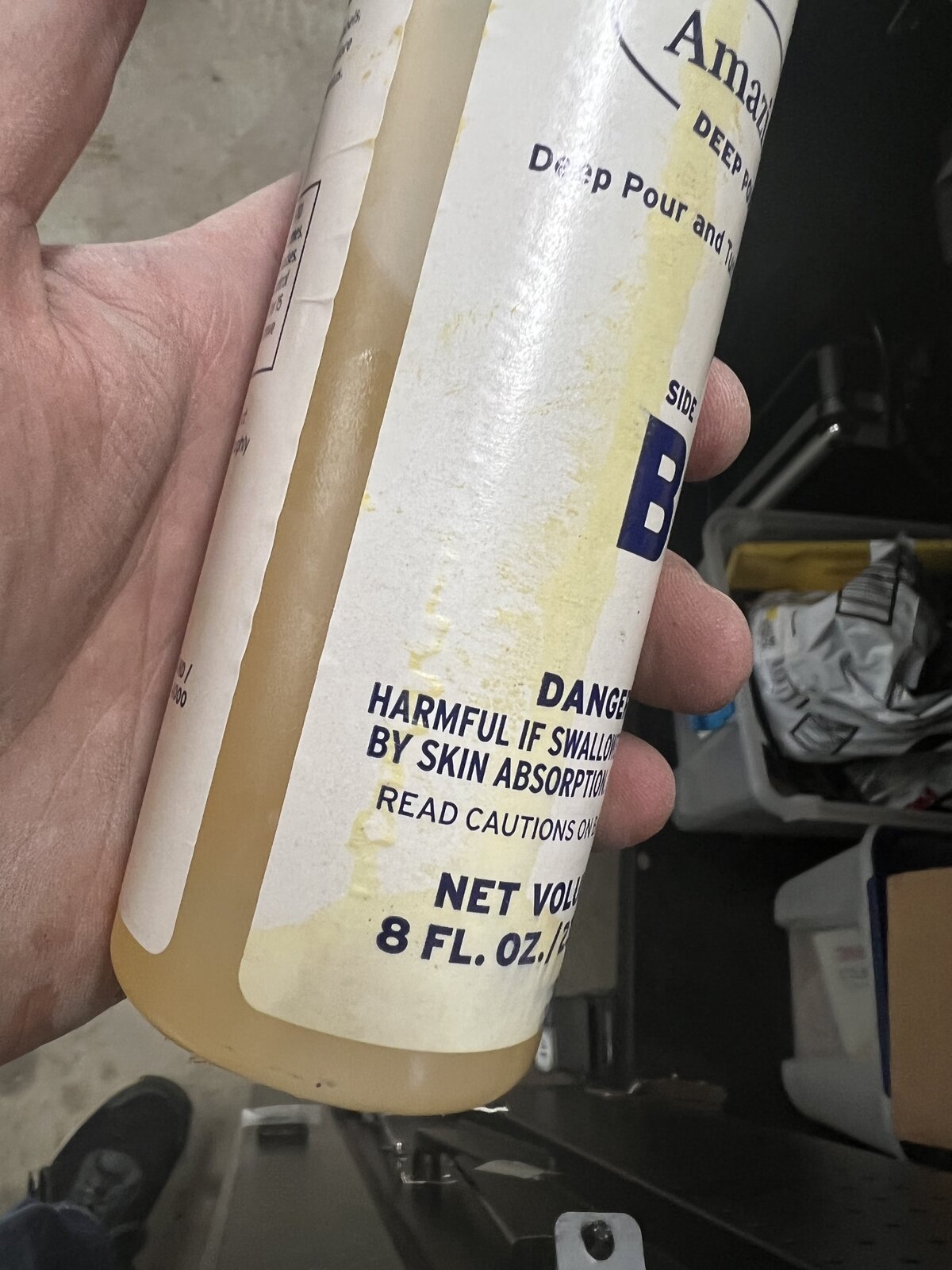

Second question: I found some epoxy resin for casting. I used some of it a few months ago. It's since turned yellow. It was clear. Is that still good?

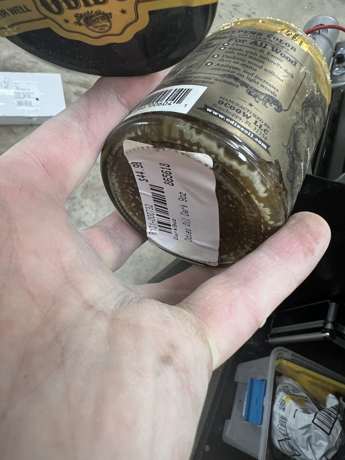

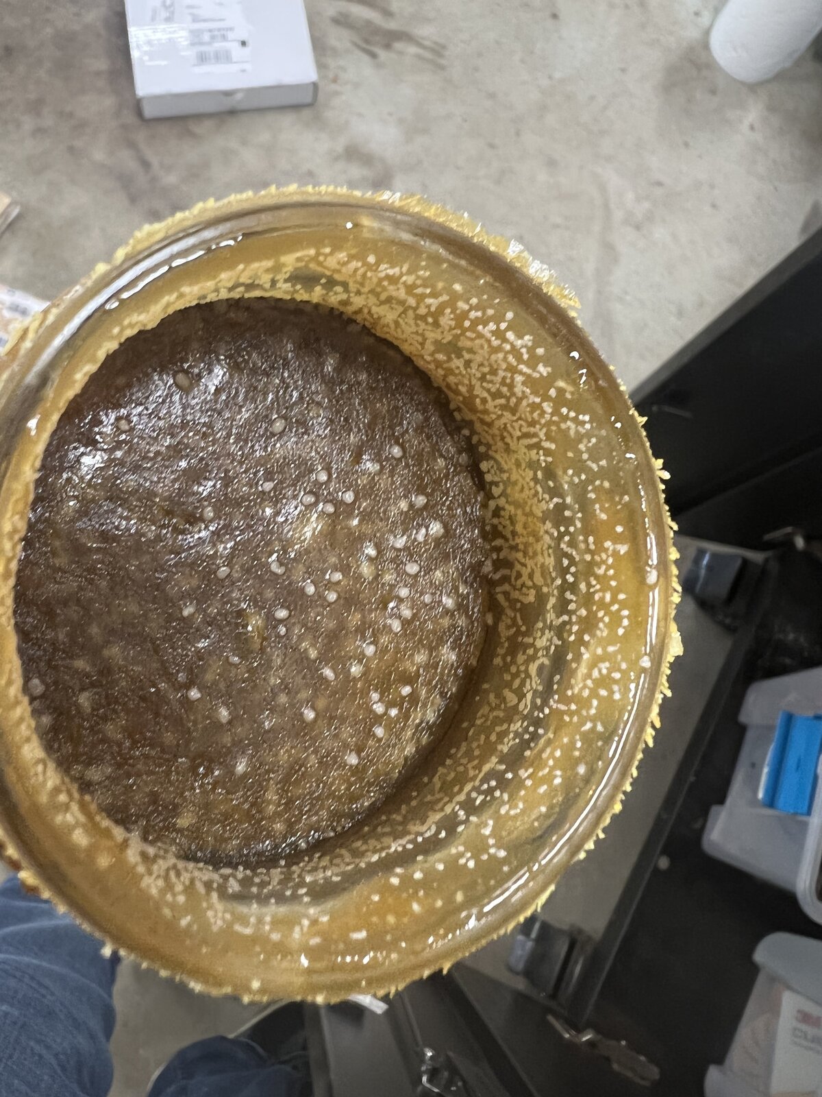

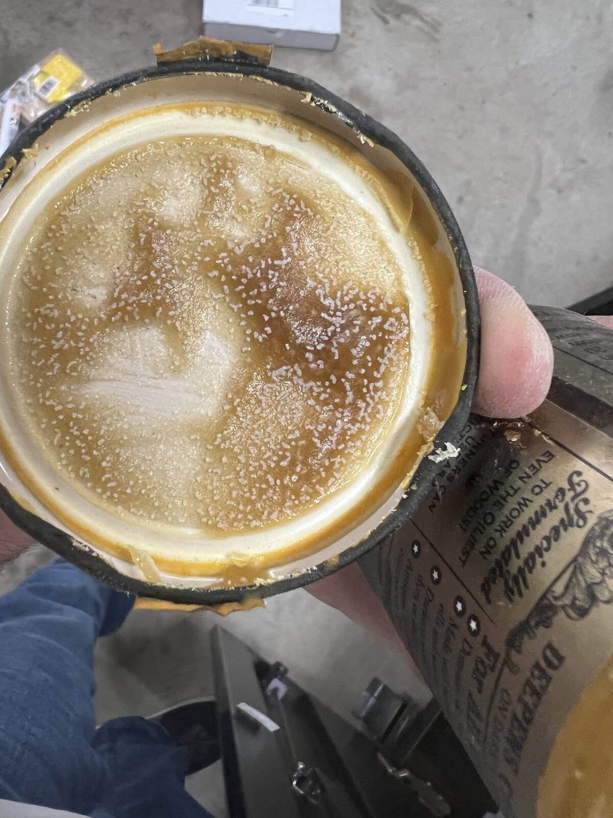

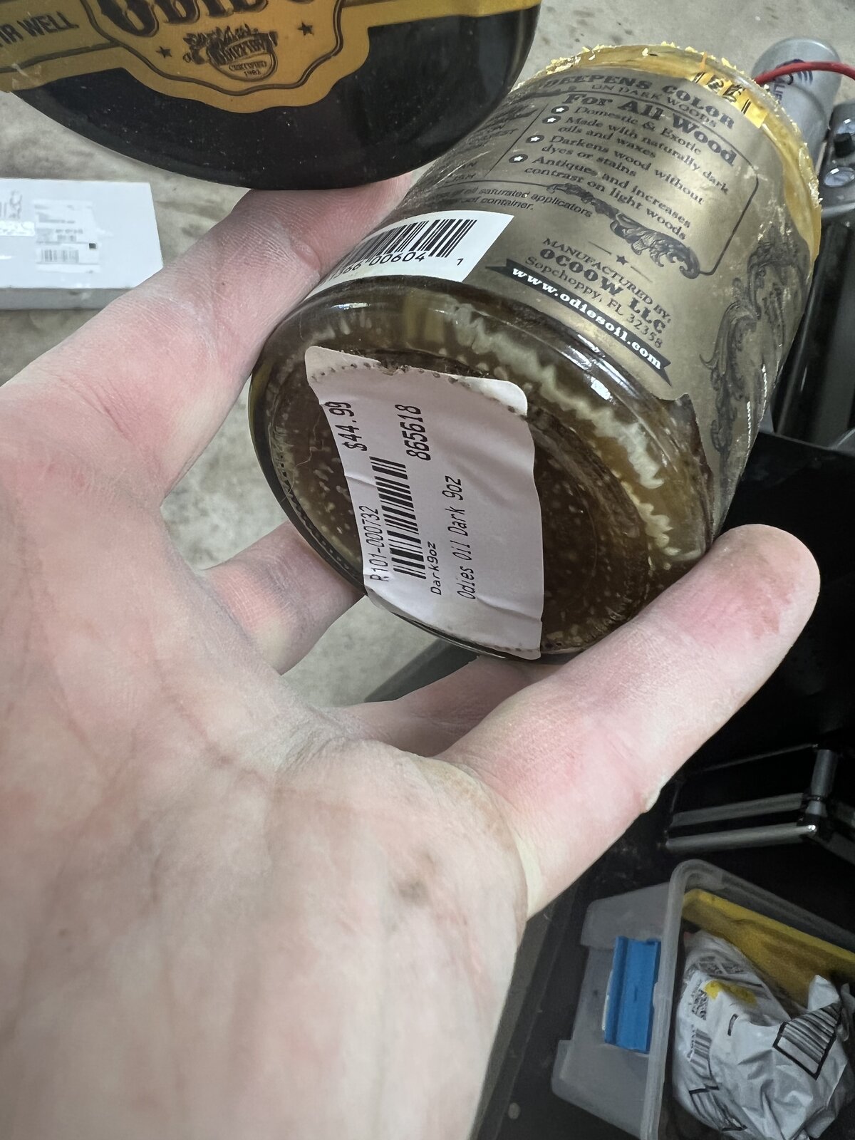

Last question: I had some Odies Oil dark develop a bunch of small white granules. Almost like yeast. Is this normal? It didn't happen in the Odies regular I had (which is much older).

Usually colouration will not affect, but resin does generally have a shelf life. Try a small mix and see if it still cures.

Thanks. That was my thinking on the shellac. I also reached out to Odie's directly, but was curious if anyone had that happen.
The epoxy resin turns yellow over time. That's one of the drawbacks of it. I think it's ok. I've used it when it was over a year old and it worked well, except for yellowing. I'd get a small cup and mix up a batch and let it sit and see what happens. Then you'd know for sure.
Update: Odies says the white grains are just the wax solidifying and coming out of solution. Not a problem. Friction when applying will melt the wax and it will be good to go. Or so I'm told.
