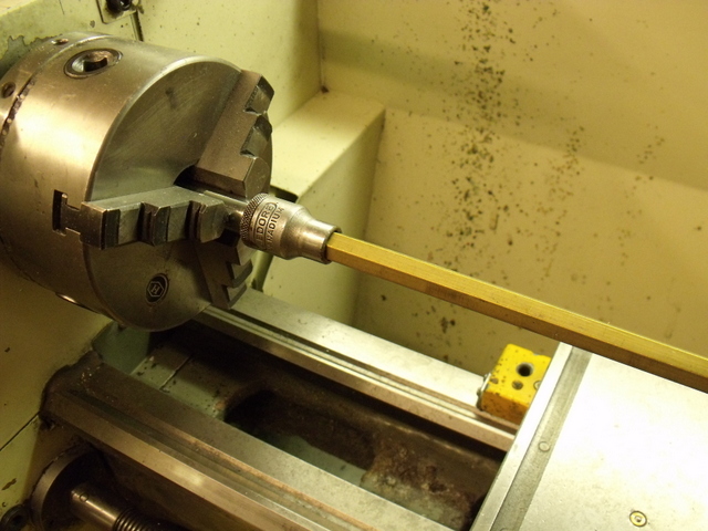

Here's a 'quick fix solution' if you are only going to do it a couple of times and are on a budget. :)
Use a socket with a short extension bar. You need either the ext bar or some other way to stop the hex rod from being simply pushed through the socket. :wink:
Here's a pic ( even though it's in a 3 jaw chuck )

I hve used 6 point and 12 point sockets in 4 jaw and collet chucks.
Depending on tolerances, you may need to shim/ wedge the stock in the socket. Long/deep sockets may help with alignment.
