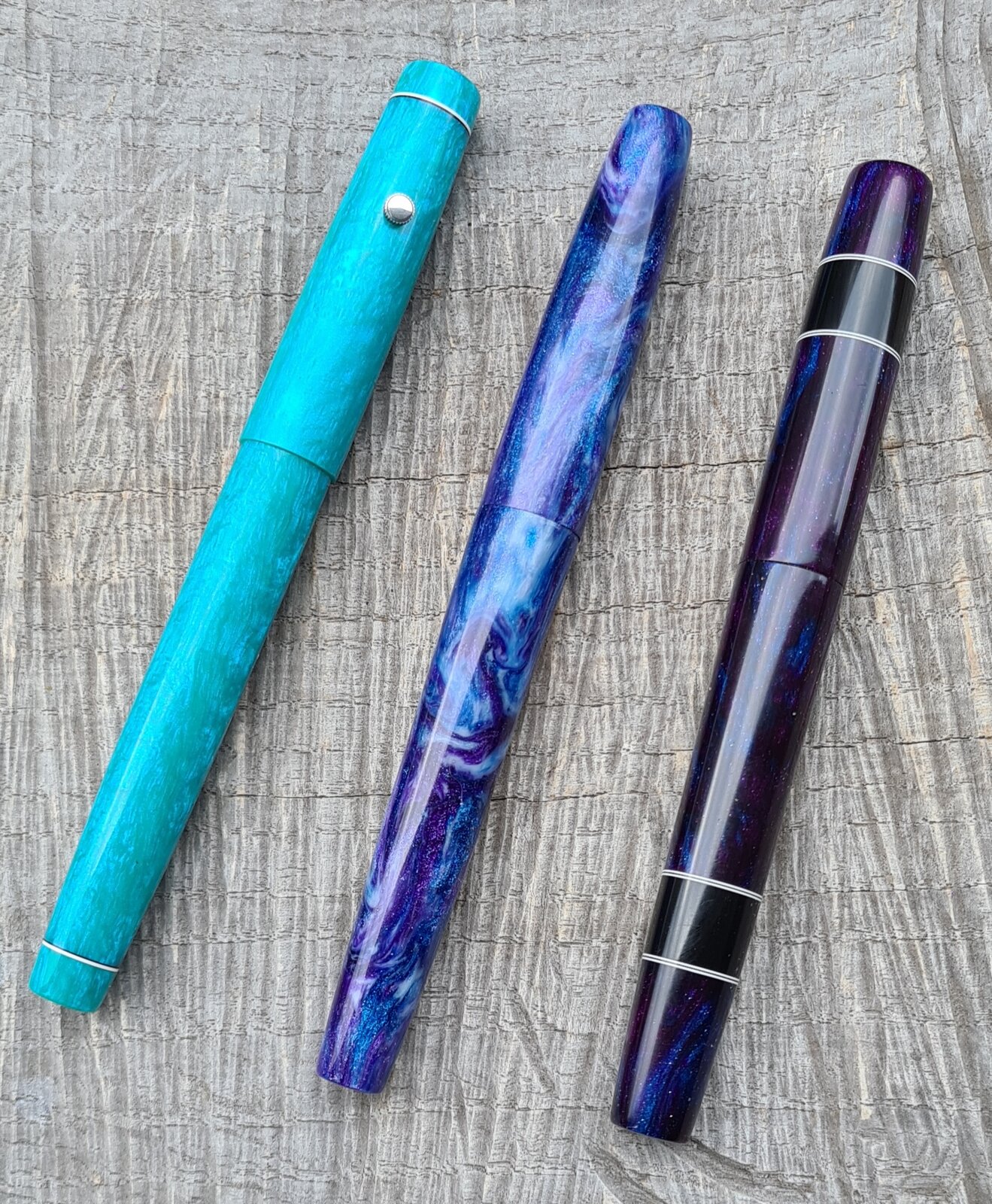

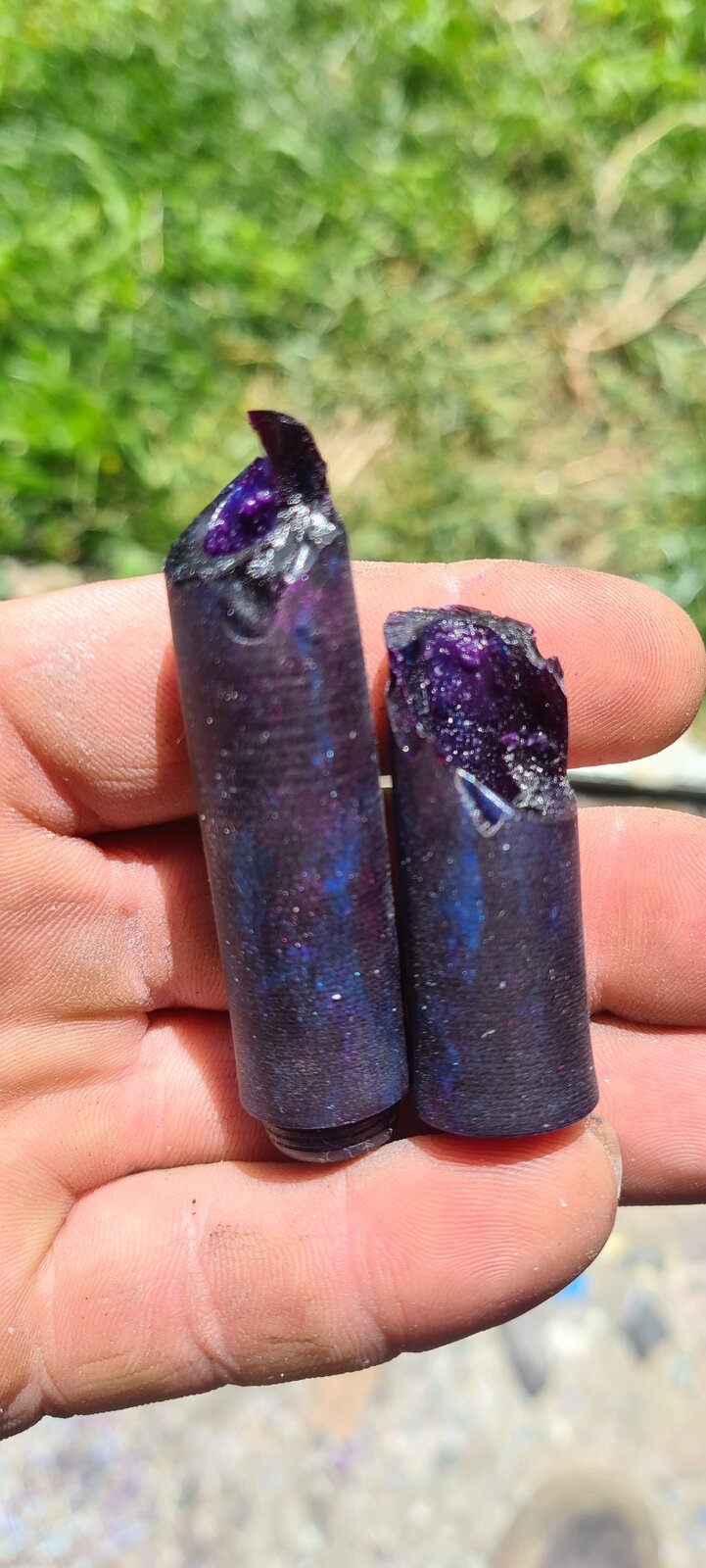

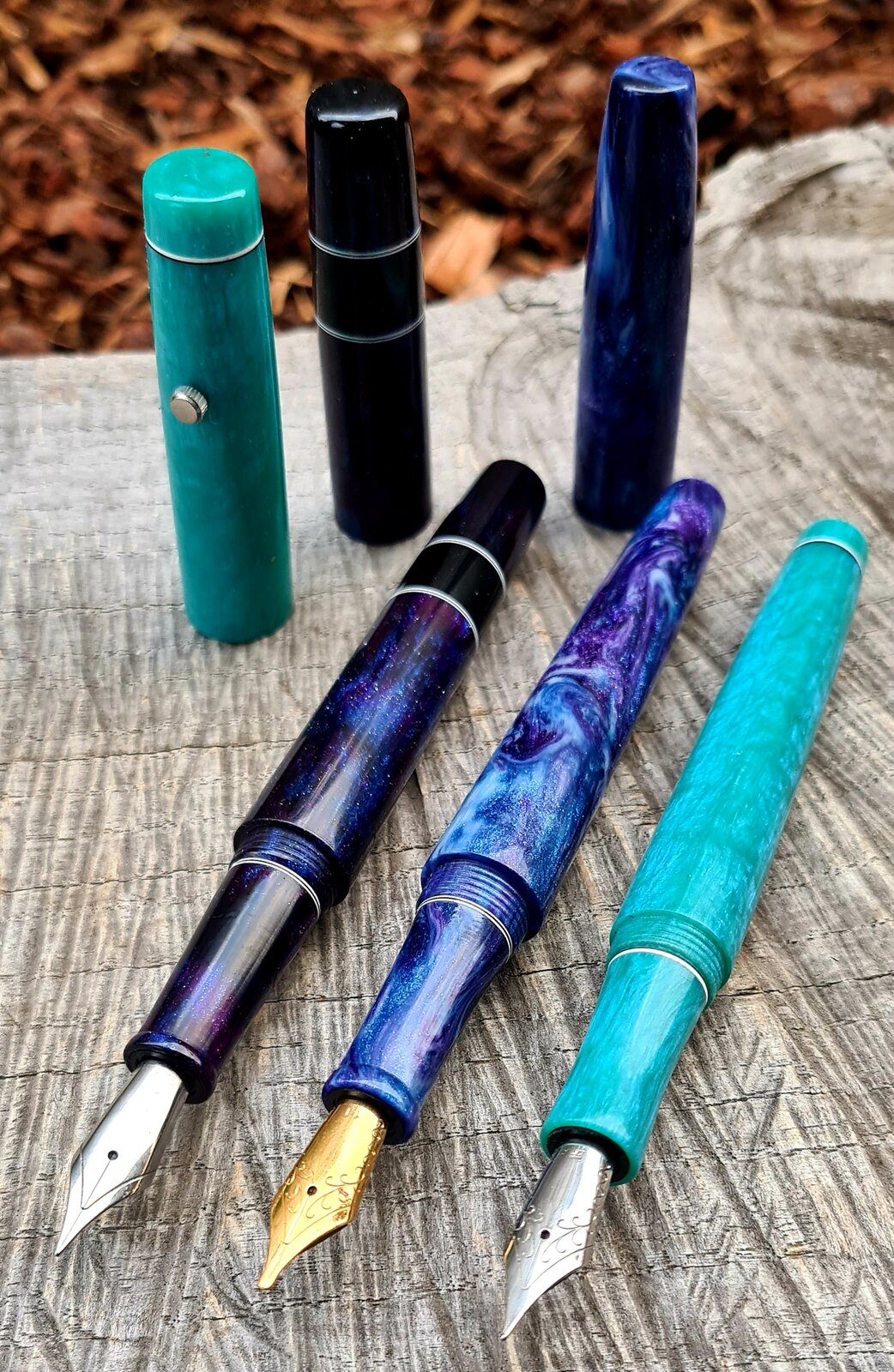

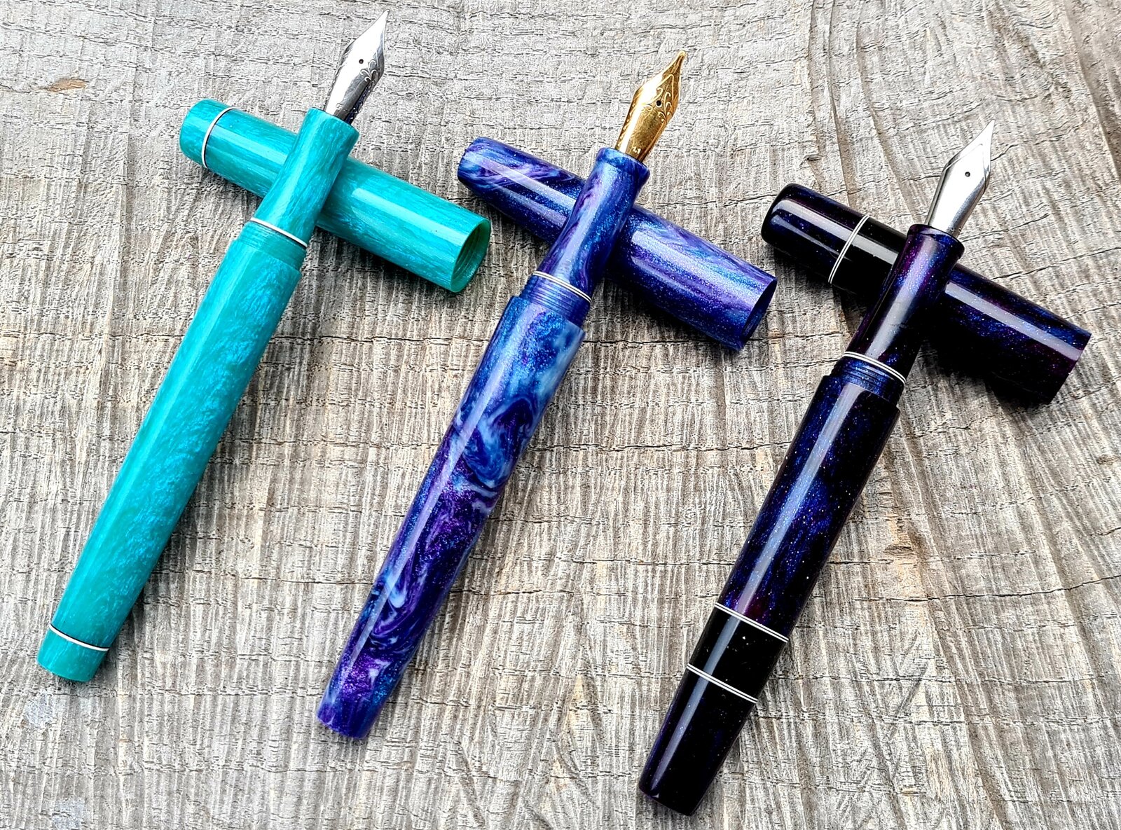

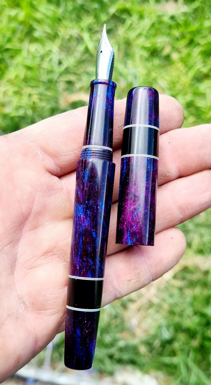

Getting through some orders today. One of the diamondcast blanks blew apart when I slipped and jabbed the chisel in! Oh well, quick redesign and it was saved!
Last pic is very questionably questionable.

Love the pens, but that last picture made me laugh quite a bit.
That 3rd one looks amazing to me. I have always been a b side guy (going back a ways ways there) and find myself the same way with pens. The mistakes cause us to discover new tricks and techniques. Beautiful save, and I really like the celestial look of that blank!
Wonderful pens, Casey . . . I especially like the blue one in the middle !!!!!
You deserve a Ph.D. in Pen-Turning !!!!
very nice!
