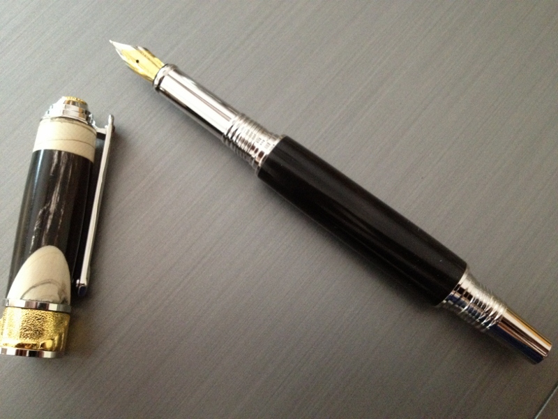

I wanted to share a few pens I've recently made using different materials.
The first an Art Deco FP with Buffalo Horn and Mammoth Ivory. I decided on Buffalo horn over Ebony as I thought the white of the horn will be pulled out by the ivory.

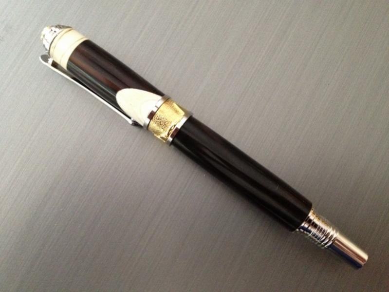

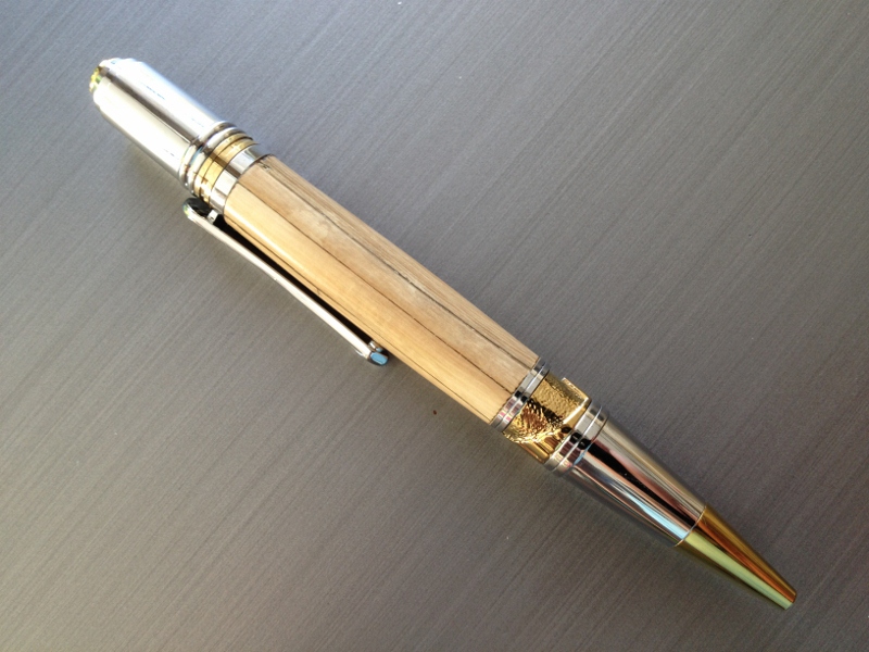

The second is an Art Deco BP with Mammoth Ivory. I had a 8" piece of tusk with two grow rings, sanded flat, cut at about 2 1/2", repeated and glued two pieces to give me enough width.

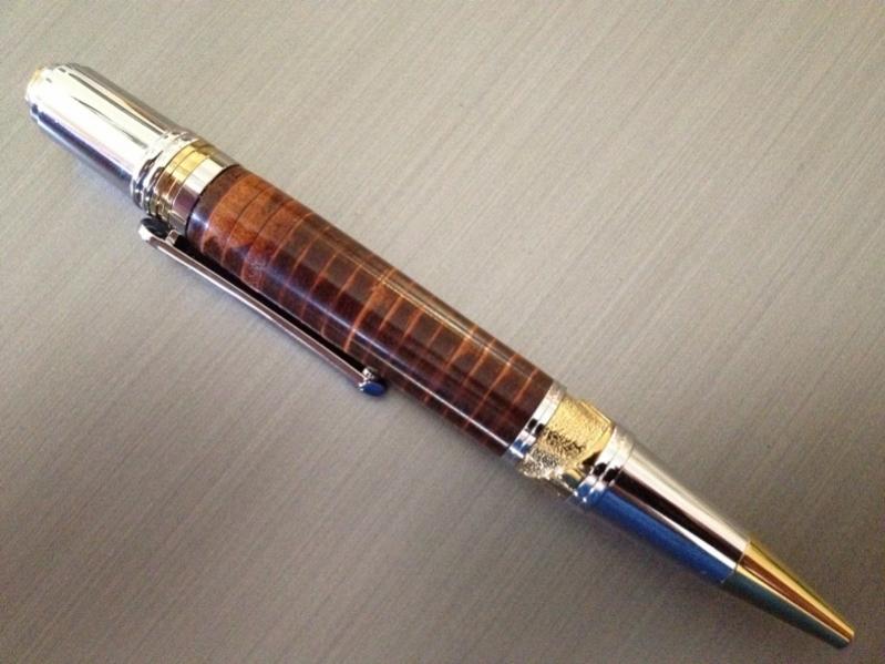

The third is an Art Deco BP with Leather. The CA really darken the leather, but left some contrast.

My favorite is the second one,that looks extra cool! Great job on them all.Could use share what those materials are like to work with?

I love the leather one. Was that some thong wrapped around the pen tube?

The ivory was rather brittle so I kept the CA close. I tired to sand down the material so there wasn't much to turn. Had a few pieces chip off at the growth rings, but easy to repair without showing cracks in the ivory.
The leather was easy to turn once hardened with CA, otherwise it's to soft to drill and turn.
Both where neat to work with and created beautiful pieces.
As for the smell, as long as I had the shop vac running, it wasn't to bad.

I cut strips of leather 3/4" square and glue them together. From there it was just stack and glue until it was long enough. I counted 18 pieces in the picture, may have be 20 before I squared it.

Nice job. I love the 1st one! What kits are you using there?

It's the Broadwell Art Deco from PSI.

Those are great Mark! The horn really stands out. Question time...would there be an advantage to vaccum stabilizing the leather as opposed to CA soaking?...just a thought.

I would think vacuum stabilizing would give constant penetration and color through the leather. You can tell by the color differences that it wasn't completely saturated with CA, but I left it that way for contrast. Also, I don't have a vacuum sealer so CA was my only option at the time.
