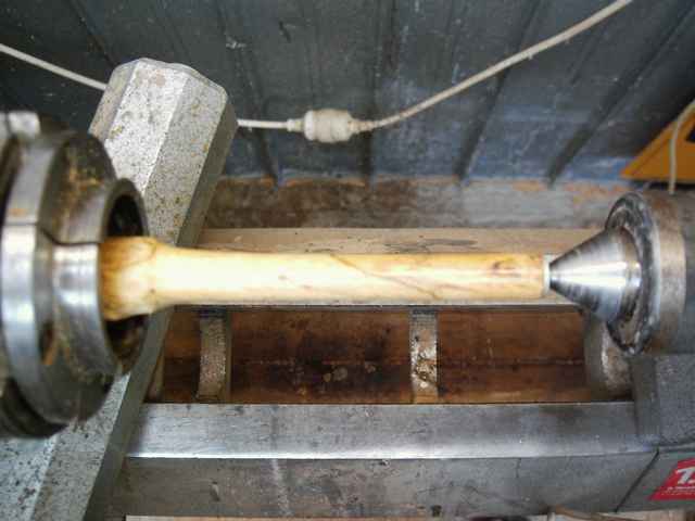

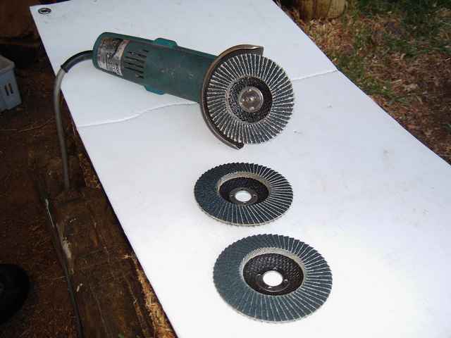

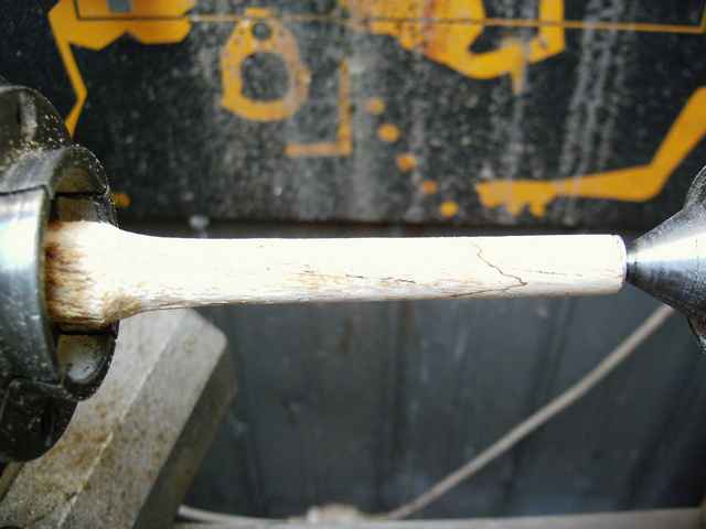

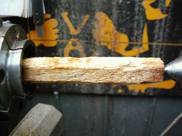

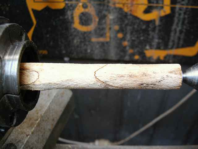

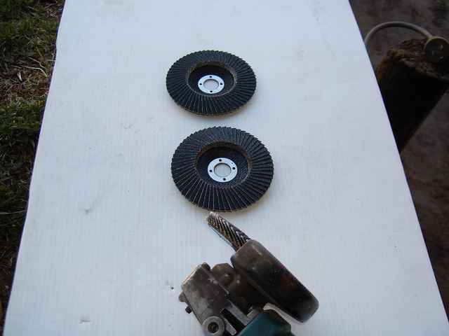

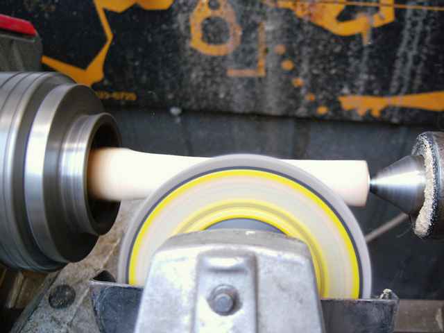

Carmen,
You may thing my suggestion is a little out of norm, just try it and your perception will chance forever, I will doubt you will ever blow another blank again...!
In the pics you see a 4" grinder with 3 stepped sanding discs, grits 40, 60 and 80. These discs are normally found at most hardware stores and they don't cost much at all, about $3.50 or so each. Use the grit you thing will suit the timber to be work (hardness/softness), gentle passes will remove the excess wood and have it shaped in no time. Until you get used to the process, stop the grinding a little before the bushings, giving you plenty of material to adjust with a skew or sanding manually to the correct size.
Just go get some discs, try it and let us know how it went! be prepare to be surprise, I'm telling you...!:biggrin::wink:
Cheers
George
