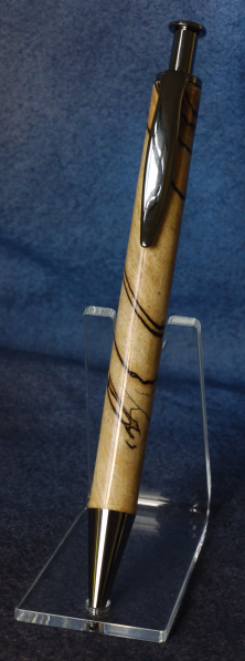

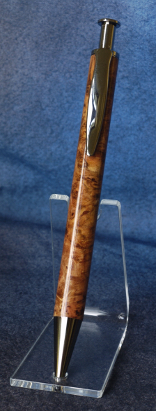

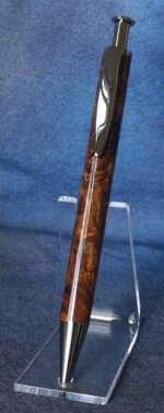

I originally finished these pens with Enduro, but was not satisfied with the result. I then refinished them using the new Stick Fast CA finishing kit. The results were much improved. I'm sold.
Left - Spalted Maple
Middle - Rosewood Burl
Right - burl (I've forgotten which one - any guesses?)

Nope - that 3rd pen isn't brown Malee.

Wondering - could the 3rd pen be afzelia burl?
