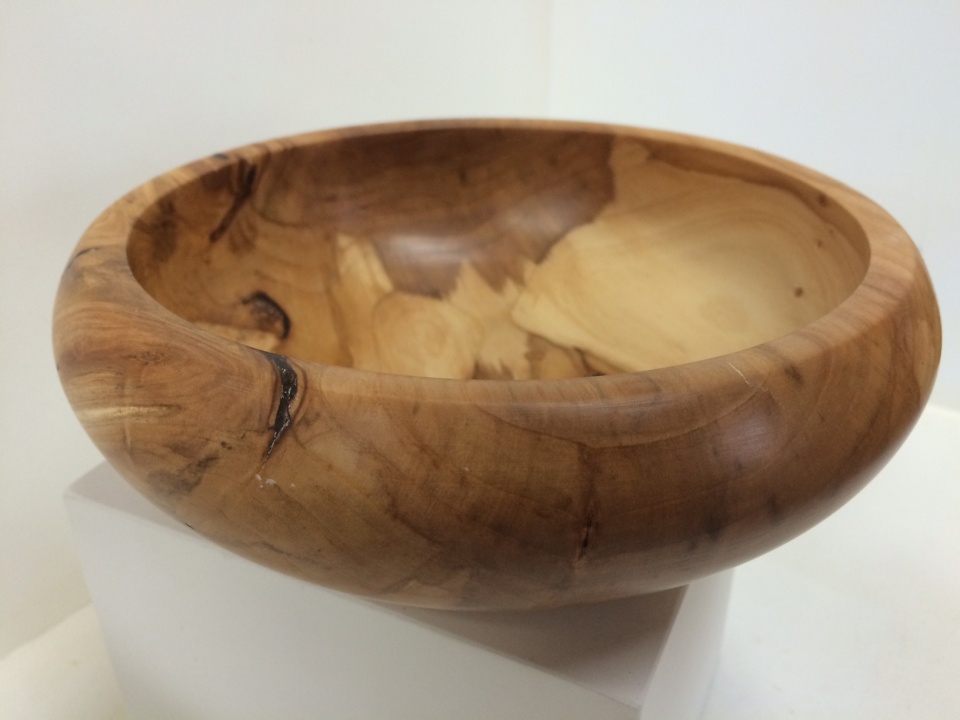

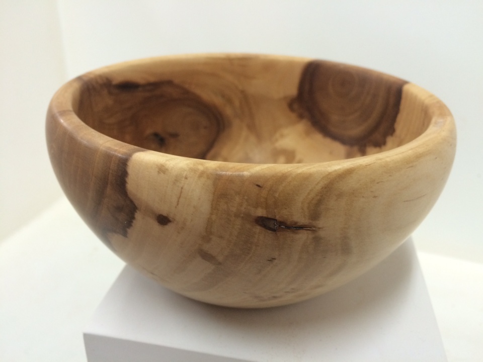

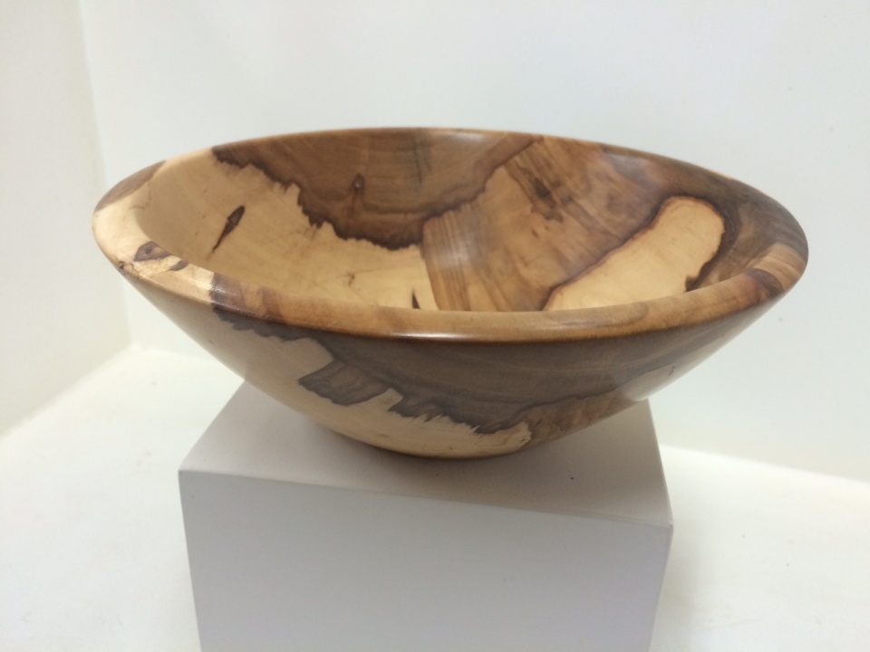

I rough turned as much of the apple as I could over the next week or so and have been pulling some of the roughed bowls out for final turning and finishing. These are the first three. I have to say I am pleased with them and thought they'd be OK to share. Gonna be hard to decide if I'll show the wood guy - might have to hide these!
attachment.php
Bowl 1 - about 8" across
attachment.php
Bowl 2 - about 6" across

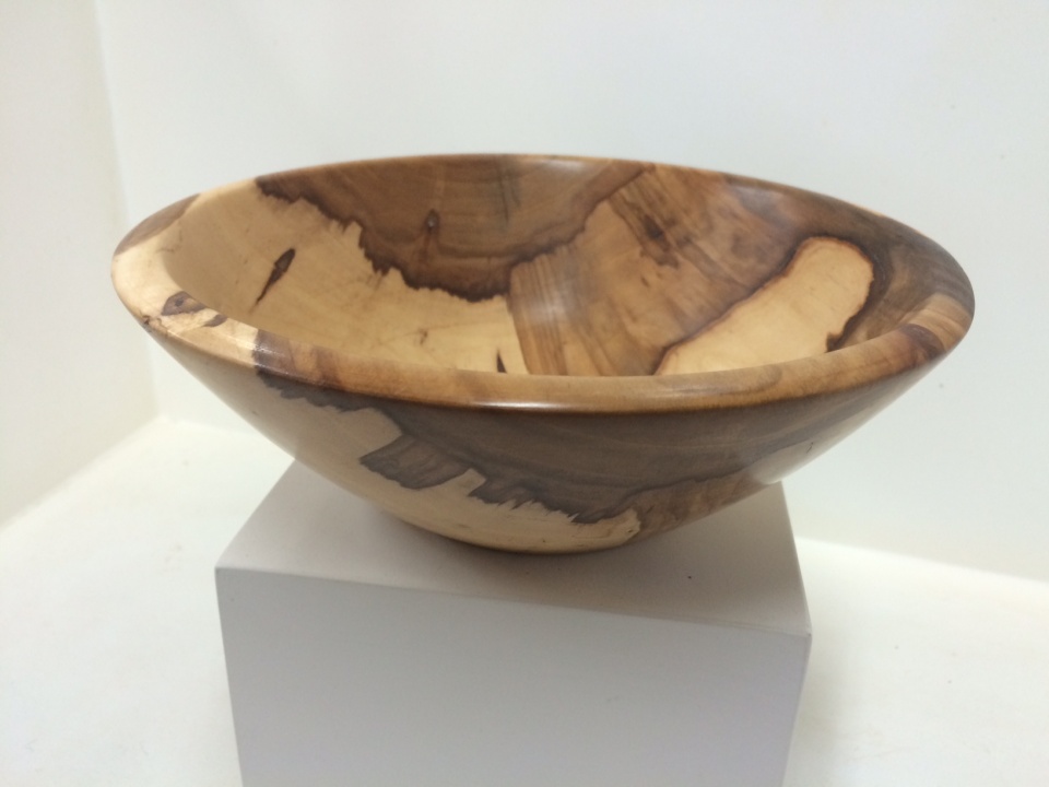

Bowl 3 - about 10" across (my favorite of the 3)
attachment.php

Very nice!
Apple tends to crack very easily and it looks like you did a great job controlling that.
What finish did you put on them?
MarkD - I used a wipe on salad bowl finish. The brand name is Behlen's Masters salad bowl finish, I believe. Multiple coats until I get an even finish then rubbed out with very, very fine steel wool.
And, yes, apple does, indeed, have a mind of its own. I did get some cracks & splits plus, as you can see, the wood was starting to deteriorate anyhow. I spent a fair amount of time filling the voids with CA before final turning and finishing. It produces a dark, almost black patch which is kind of nice on the apple.
