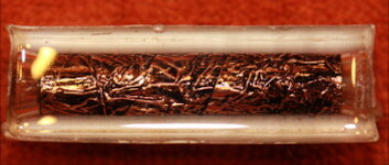

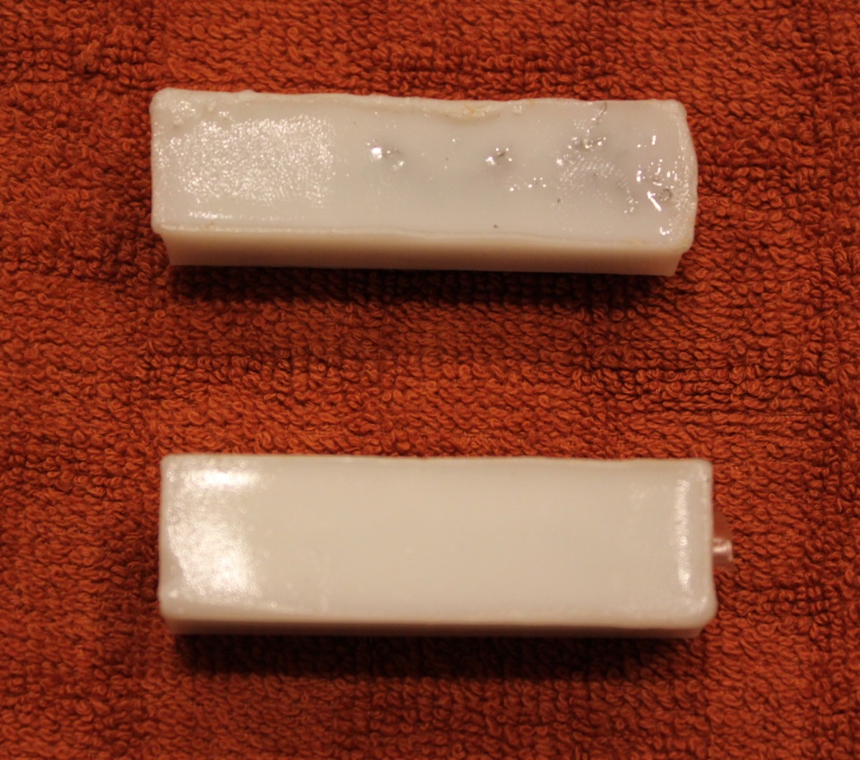

First picture is of my "test" blanks to see if the system worked. No question - NOT... Moisture? Old Alumilite? Poor mixing? All of the above.

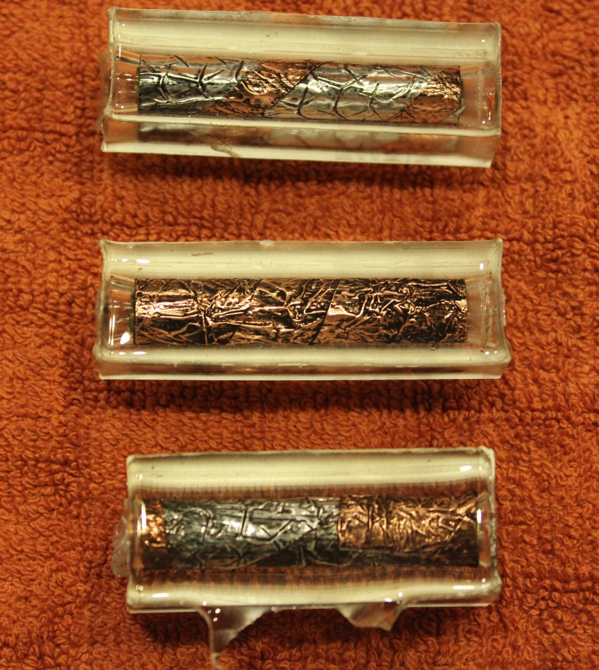

Well, I had 4 blanks made for Bob, and they were equally useless without casting, so 15 minutes later 3 went in. Same conditions... Same lab rat running the pressure pot...

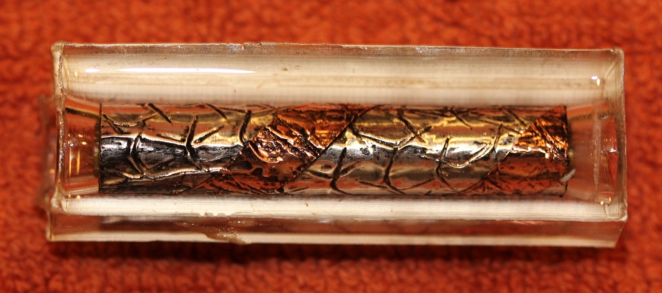

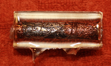

Pictures 2-5 are of 3 foil blanks for Bob (only had silcone stoppers for 3).
Other than a few specks of dirt/dust, they are very clear and bubble free.
Not sure why... But at least the important blanks came out. I'd like to make 3 more just to have some extras for Bob to choose from, so I'll try on Tuesday or Wednesday.

I had that same problem with old alumilite. Hate it when that happens
Actually... I think it was the lab rat (me). I had 2 blanks previously painted 2 months ago. I coated with medium CA, coated with Aluminum shavings from my PITH project. Applied accelerator. Let sit for 2 hrs, then cast. I think a 3-5 day de-gas was needed.
There was no difference between the runs other than the CA. My mistake, I knew better.
However, I believe my Alumilite and pressure pot is fine, so I will remake the blanks, wait 1-2 weeks then try again :smile:.
So, a lesson learned!
Just my .02¢….when you're mixing your AL, make sure you always pour/weigh the "A" side first….Always! If you pour/weigh the "B" side first and then add the "A" side last, you will get the milky, opaque mess going. I called Alumilite and verified this fact. There is a method to the madness and there is an order to the sequence of pouring. I don't pretend to understand the chemistry of it all, but I have learned to do it the Alumilite way:wink:
