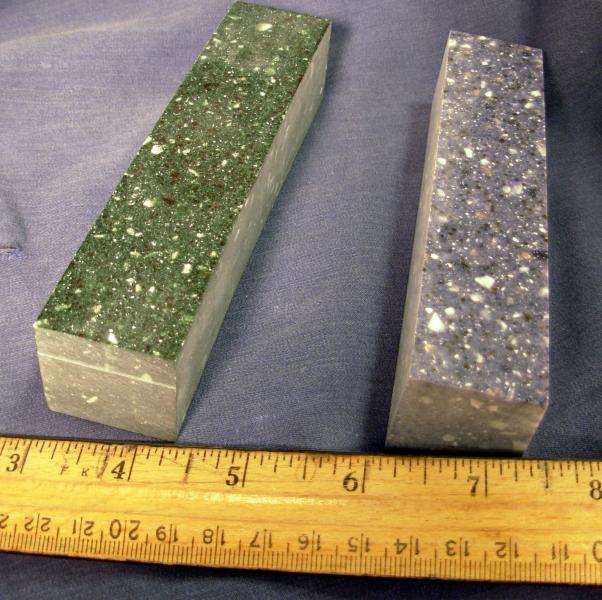

I've got some 3cm stuff if your interested. Green sand, black pebble, blue pebble, green pebble, and white pebble.
And no, it wasn't glued. It's 3cm, and there's only one company who makes it that thick.
If it is Coriam....there is only one company that makes it period !!
Your right. I should have said that, "I have 3cm solid surface. "
So sorry. Most I've seen around here use "Corian" as a general term for all the solid surface brands.

I have some 3/4" Corian brand that is NOT glued up. It has not been made for about 20 years but YES it is Corian and yes it is 20 years old, but it never gets old. The colors are limited because back then it was usually, pink,whites, beige colors,some blacks and some grey.
There are a couple of companies making 3/4" again but it is really hard to get.
BTW corian brand adhesive is liquid corian and when cures there is NO seam. Corian is acrylic, brands like Avonite have many colors made with all polyester and even with the Avonite brand adhesive some will show seams.
If you use CA glue correctly and use Corian either with no pattern or very little you can get two pieces glued together without the joint showing.
