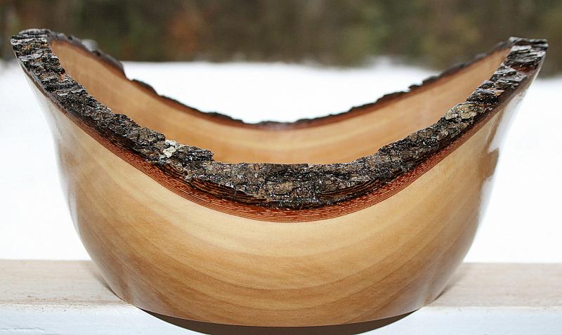

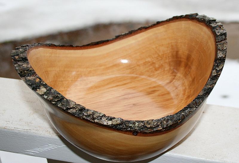

This is the 2nd try. It turned out pretty well. I like this bowl a lot better than the tree. It was a Bradford Pear from my front yard:rolleyes:. I will be making a few more of these in the near future. It is 8" across and 4" tall. Enjoy, Russell

Nice bowl, Russell. I think you should keep it in the kitchen......filled with pears:).
It might encourage your pear trees to keep producing.

The finish is rattle can spray lacquer, Deft brand. It has a total of 4 coats, it takes a while to dry when its cold. I set this one in front of my heater to speed the drying process. It takes half the time that way. Thanks for the comments. Russell

Russell ... Another excellent display of turning talent. Would you post a photograph of the bottom of either (or both) of your bowls please. I personally like to observe how folks treat the bottom of certain types of turnings.

Nice form and fantastic finish! I like Bradford Pear but never did a natural edge bowl with it.

I will try to post some pictures of the bottom tomorrow. The only way I know to keep the bark on the bowl is to soak it with thin ca glue. I mean SOAK it! I usually turn the bottom and get the shape round then apply it. One more hint is to make your "cut" inwards toward the bark NOT from the bottom outward. That will help keep the bark intact. Also bee very careful to not get hit with the "wings" of the bowl when sanding the bowl:eek: it can be a attention getter:cool: And don't ask how I know... Thanks again for the comments. Russell
