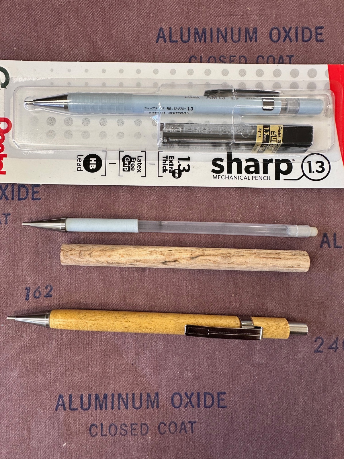

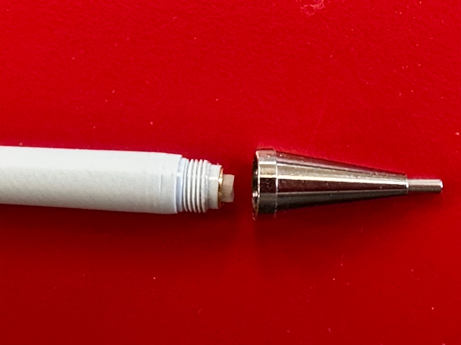

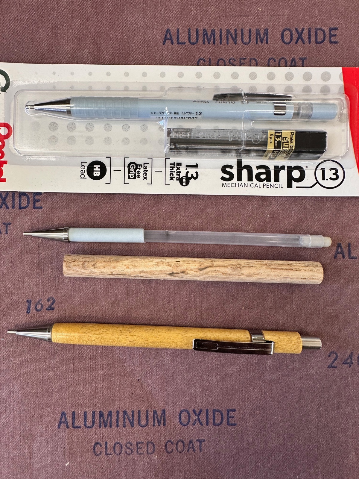

Pentel conversion of the Sharp 1.3 is little different as they use the body to hold the mechanism. See attached one this show kit and completed pencil, I like the 1.3 lead ion the shop use.
Dale: no tutorial. I drill straight hole in blank. Take the org pen and turn off body leave couple inches, turn it down to fit your 5/16 hole. Important is when epoxying body it blank make sure. Not to get epoxy on tip as it will jam up operation.Thanks for the information. Is there a tutorial for this model or is it just a straight hole all the way through?
