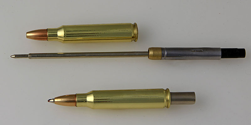

Perhaps this photo will help illustrate the problem:
attachment.php
Note that the top cartridge is shorter than the cross-style refill, so you can't just cut the tube flush to the case head and insert a 7mm transmission. To use a cross-style refill, your options are:
  1. Leave the tube extending quite a ways from the case head. You'll need to recess the tube in the upper barrel a corresponding amount - which leaves the barrel material unsupported.
  2. Shorten the refill. Now the refill is non-standard so the customer cannot easily replace it when empty. Also, if you aren't careful shortening the refill, it can make quite a mess.
The lower cartridge has a mini-cross-style refill installed. The 7mm transmission is inserted fairly deep, but there's still enough sticking out to engage the upper barrel.
I hope that helps,
Eric

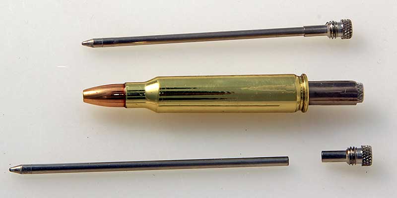

Do you have photo of the mini-cross refill installed in the transmission like the top photo?
My previous photo shows the 223 cartridge with the mini-cross-style refill extended. The photo below shows the same cartridge with the refill retracted. You can see it extending from the transmission. A refill with adapter (that screws into a 7mm transmission) attached is shown above the cartridge. A refill separated from the adapter is shown below.
attachment.php
The mini-cross-style refill and adapter are what come with the credit-card pen and the teacher's pen kits. The refills themselves (without adapters) are available at office supply stores.
I've run across adapters with two different threads - one that fits a standard 7mm transmission, and one that doesn't. Some teacher's pen kits have non-standard transmissions. I don't use the teacher's pen transmissions (for reasons stated above), so I'm careful to buy the standard ones.
