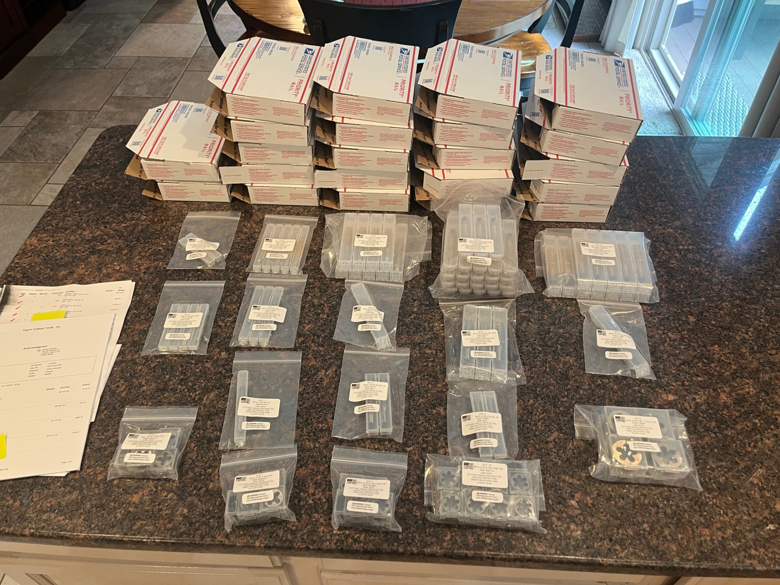

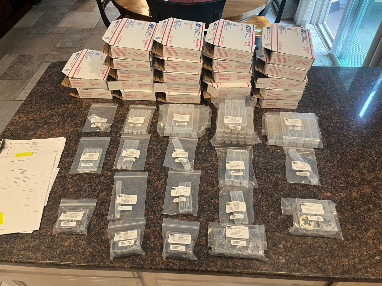

It's a typical Thursday afternoon. ;) I got in a boatload of taps and dies from Tapco, and I'm getting ready to split up the orders for all of the group buy members and ship them out. It doesn't look like a lot, but we placed a $11,000 group buy order through Tapco.
If anyone needs me to hold a package, please let me know. Otherwise, I plan to ship out on either Saturday or Monday.
Everyone should have a PM with tracking information by now. All packages, except for one that I am holding, and the couple where I screwed up on TiN coatings that are being fixed, will go out on Monday morning. If anyone did not receive tracking info, please let me know.
Thank you!
This is a beautiful sight!
