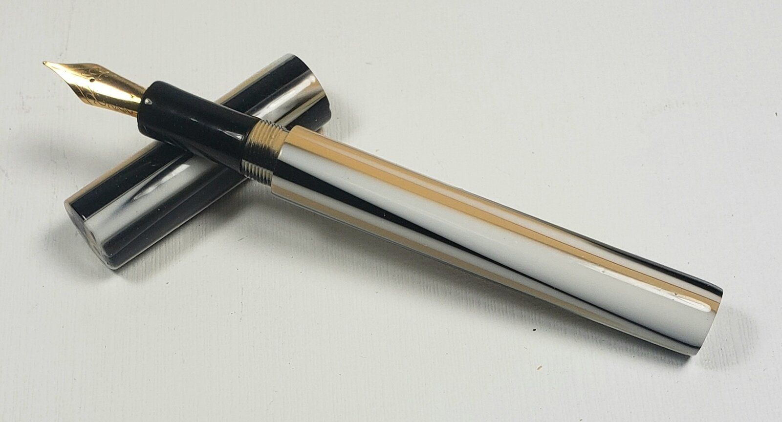

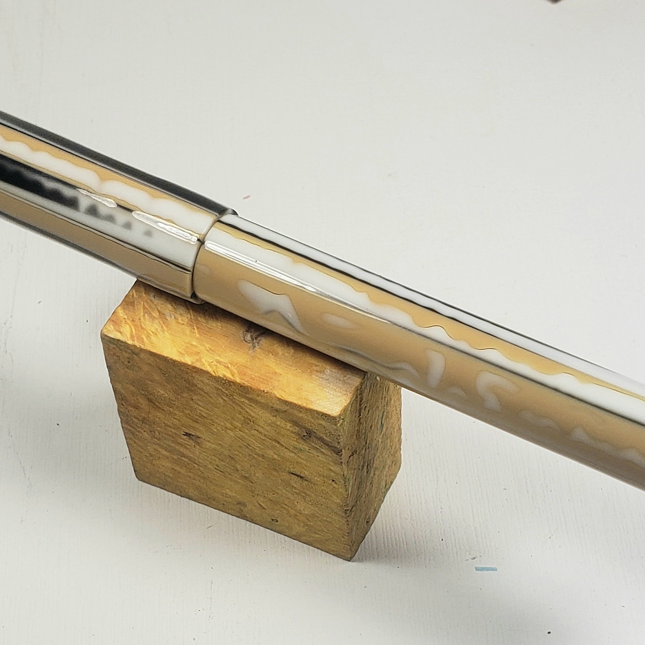

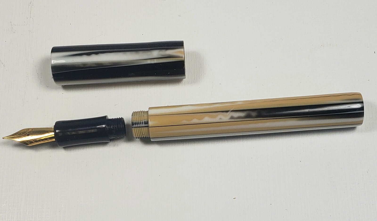

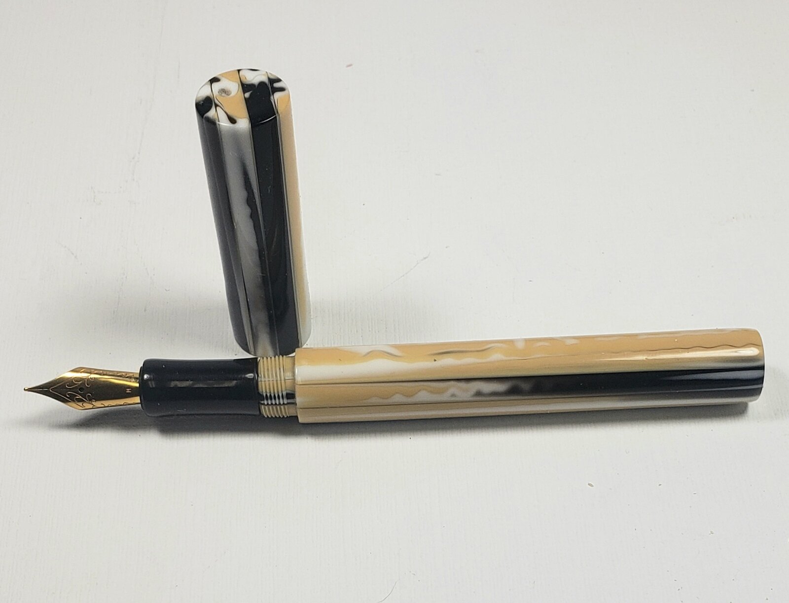

Acrylic acetate. Total length 6.08. Cap length 2.38. Barrel length 3.70. Cap-Barrel threads M13 x .8. Section-Barrel threads M10 x 1. JoWo #6 nib/feed unit.
Cap diameter: .70"
Barrel diameter: .60"
Enjoy and comments welcome.
Do a good turn daily!
Don
IMG_20210113_210539_060.jpgIMG_20210113_210432_832.jpg20210113_205812.jpg20210113_205608.jpg
Nice work, Don !!
I am glad to see a "slightly larger" pen !!
Now, if I go ahead and do the same I will feel that I am in good company !! . :D
Plenty of nice things in this pen Don. Did you glue the blank?
The only detail that I could be less found of is the barrel-section step. First, 2 mm OD difference is too much for my taste, as well as the way to make the barrel threads thinner at the beginning of them - instead of taking some meat off the cap.
But a very elegant pen nevertheless. 👍
