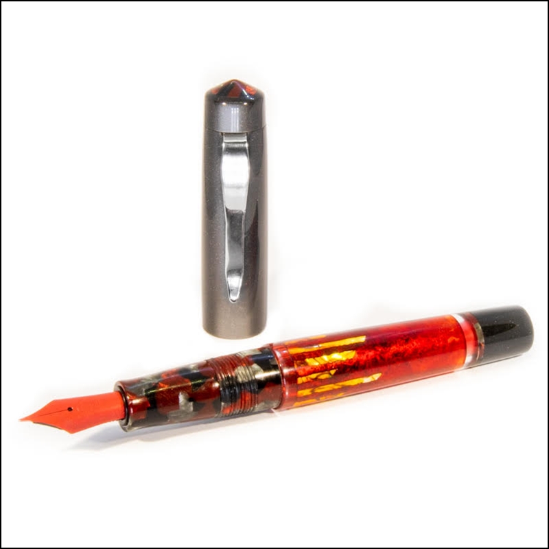

Entry 12
This is my kitless pen submission. The fountain pen was made from the many materials (Listed at the end) to the dimensions described at the end as well. The unique thing that I was trying to accomplish was to create something beautiful both on the outside and inside. The barrel of the pen was a clear resin to start with and was hand painted with silver paint first, giving it a textured look underneath. Then several thin layers of a clear red paint were applied. And finally the abalone strips were cut and placed on top of the painted barrel. Then a final layer of red paint was applied on top. Then the red paint that was on top of the abalone was sanded off to expose the yellow of the shell again. A clear coat was applied on top to protect it all and sanded and buffed to perfection. The neat thing is that the barrel remains translucent. There was a small part in the front of the barrel that was kept clear on purpose to create an ink window (functional) and also at the end to see the red of the extended part of the converter (aesthetics).
This pen can be filled in two different ways. You can unscrew the nib section and fill it like normal with the converter. If you do this you will see the beauty within. I also hand painted the converter with several layers of the same red and also some black paint. I tried blending both colors together so there was a nice transition. The paints are translucent in color as well. Next, gold leaf was applies on top of the paint. Finally a clear coat was applied to protect the paint. The front of the converter was left clear so that one could still see the ink level through the ink window. The other option for filling the pen is that you can unscrew the blind cap to reveal the red extension of the converter and fill it like you would a piston filler. There is no worry about the converter coming off because a K6 converter which was threaded into the nib section.
I thought it was very fitting to fit the pen with a bock red nib and also has a stainless steel clip. Thanks for looking.
This pen was made from a variety of materials:
Vintage French Acetate
Clear resin
Omas Bologna Pearl Grey Acrylate
Red resin for extending the converter
Paint
Gold Leaf
Abalone shell
#6 Bock nib
K6- Threaded converter
Stainless Steel clip
Dimensions of the pen are as follows:
Length: 5.5 inches
CAP diameter at largest point : 16.8 mm
Body Diameter at largest point : 15.5 mm
The threads of the pen are 14 mm
