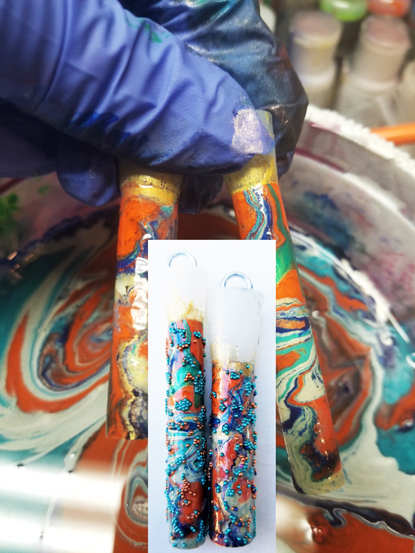

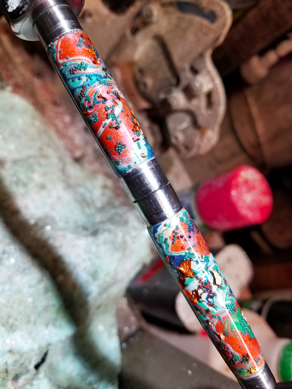

Entry 8
Steps: Rough-sanded acetone washed brass tubes. Coated them with alum, let dry for 8 hours. Marbled the tubes into a floating acrylic painting on top of methylcellulose-thickened distilled water. Rinsed them in distilled water, then dried the marbled tubes for 3 days. Adhered .6mm undrilled microbeads to the tubes under high magnification, using micro-forceps and Judikins Diamond Glaze. Dried them for 2 days. Applied a very thin layer of Judikins Diamond Glaze mixed with a tiny bitof cerulean blue mica powder. Dried them for 3 days. Cast them tube-in withDouglas and Sturgess Clear Polyester Casting Resin, 50psi. Cured the castingfor 1 week. Milled the ends. Lathe turned them. Sanded them on the lathe from400 grit up to 12,000 grit. Assembled the Virage Fountain Pen.
173501
173502
173503
173504
