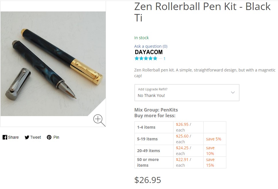

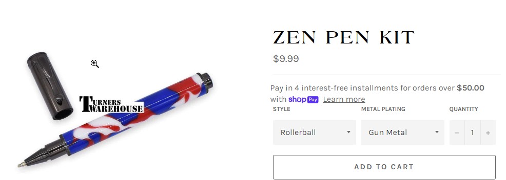

So I recently bought some Zen pen kits, haven't determined my pricing yet. Was looking around online as to what others are charging and it seemed lots were pretty much giving them away. I have found pen kits with the same name and same general look but two very different prices. I bought the more expensive ones. Look sat the nib ends, they are different. What gives? I certainly am not going to sell a pen that I paid 27 dollars for not even counting the blank for thirty bucks as I see others are. Now I know there are cheaper versions of similar pens, but as far as I know they are not named the same.

The cheaper ones are Chinese the more expensive ones are from Taiwan. There's a BIG quality difference in both the magnet and the plating. I found the gold ones from China barely hold the cap on vs the ones from Taiwan have a solid connection.
https://www.woodturnerscatalog.com/p/2/4104/artisan-Zen-Rollerball-Pen-Kit?term=zen&term=zen <-- another option for the ones from Taiwan.
Well I'm glad I bought the better ones. I figured as much, but I feel the names should not be the same.
Tim is correct on this info. Turners warehouse is selling the Rizheng kits who do not refer to them as a Zen just a magnetic cap pen kit. What is also interesting is that Turner's instructions show the more expensive kit. The zen Tim links is actually a JR. Zen. It has even a different nib section that is more elongated if that means anything to you.

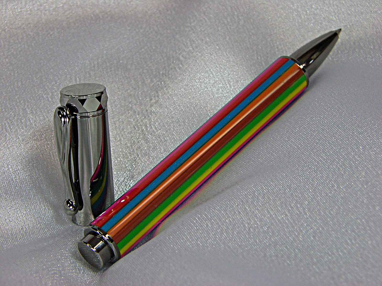

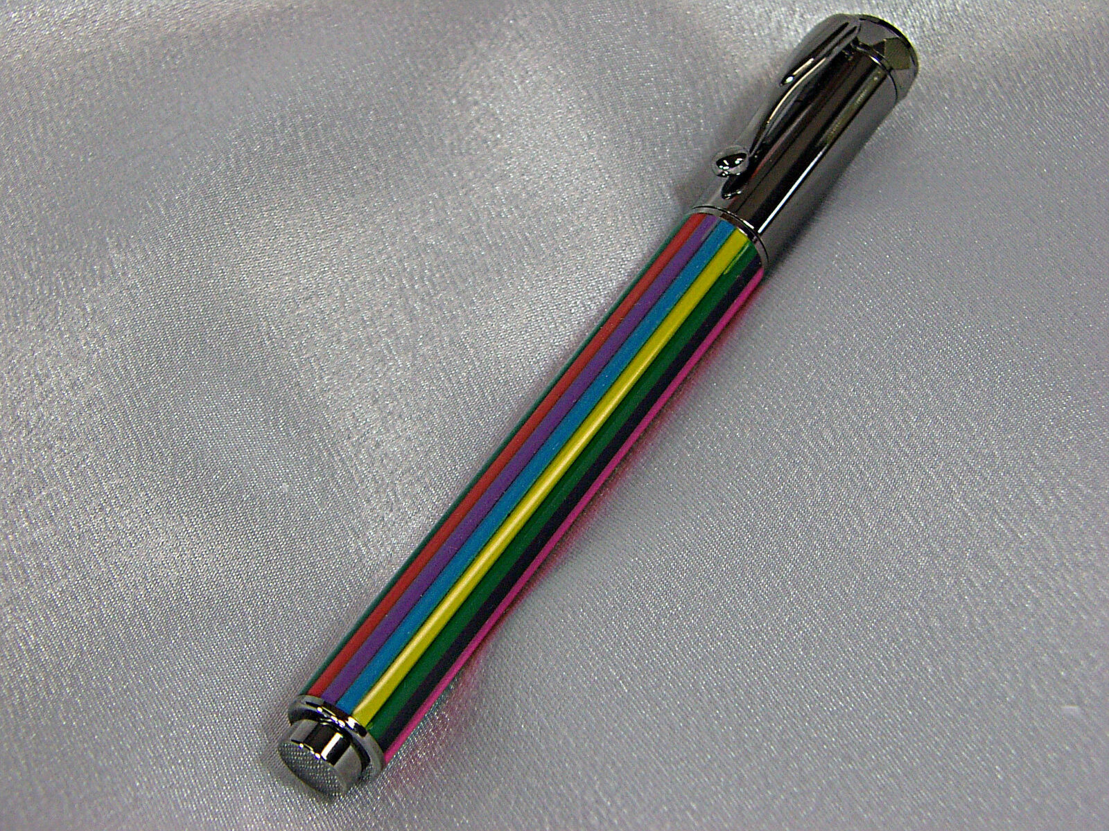

As far as you other point about price. I only made a couple of them and I do find them a little awkward to write with because of the nib section. But as far as price point this pen is $90. Not sure if that helps. But I do not undersell my pens because others are selling at cheaper prices. I have done OK selling at shows. I sell more scrollsawn stuff though.
This pen happens to be my version of the colored pencil blanks you see often. I just used the lead. :) Believe I entered in a Bash contest, I forgot.
