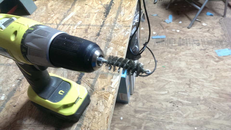

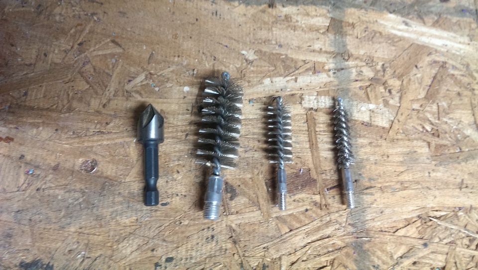

A chamfer bit and a bore brush. After the tube is glued in and set ( I use both CA and epoxy ) Chamfer the ends of the tube with the bit and then chuck a bore brush in your cordless drill or drill press and clean the tube ! Fast and easy. perfectly cleans your tubes!!

I do exactly the same thing, the little brushes are called high speed tube brushes or bottle brushes, I get mine from McMaster Carr http://www.mcmaster.com/#standard-tube-brushes/=xlaagb first style on that page, second type brush listed, lots of the industrial supply folks carry them,-just pay attention to the OD you order, I actually usually go a little larger than the tubes I will be brushing out because the tube brushes 'compact' the bristles a little bit--so for a good tight fit I go slightly oversize. The chamfer I use is intended for reloading ammunition, designed to chamfer the brass cartridge cases before seating a soft (relatively) bullet into the case--they are readily available from folks like Midway USA, Sinclair Intn'l and Brownells. Rodney's does look like a countersink, readily available at your local Home Depot or Lowes.
Good luck--it does a nice job BTW

The chamfer bit is a countersink, I bought it at Lowes. I don't put the countersink in a drill, I just twist it by hand. the bore brushes I gut at gun shows. they run $1 or $2 per brush. They do a great job, very quick and last a long time.
Turning the countersink makes great sense. Good idea.
I bet if pen suppliers carries those brushes they'd sell some.
