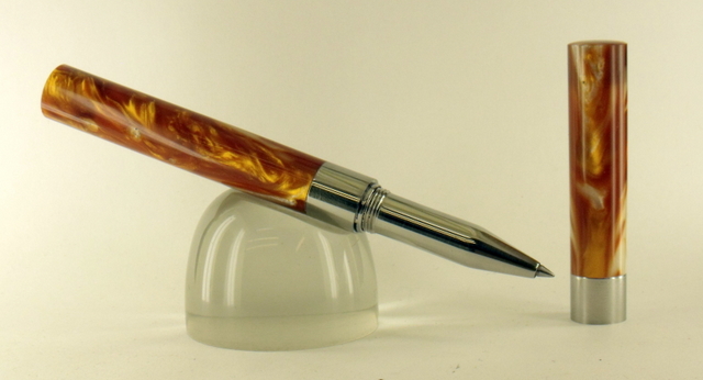

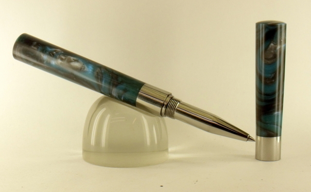

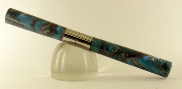

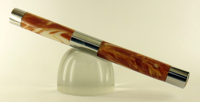

Here are a pair of basic double closed ended kitless pens. Stainless as usual with a #63 Timberbits blank ( orangey one ) and the other I think is ElMostro's. Both rollerballs.
The orange one is straight B2B but other has a taper to both ends.

It looks like the orange resin is translucent enough to see where you stopped drilling on the cap. I wonder if you had flared the orange one (like you did the blue one) if it would have been opaque enough at the end to not allow the transition from drilled to undrilled to show? Not having the transition area show on translucent closed end resins is something I continue to struggle with.

Ed, you are 100% correct about seeing through the resin. It's a big deal and I always hate seeing it. I often comment on seeing threads and saying that it spoils a pen. I have a plan to add ss finials to sort it out.:wink:

Hi Ty - Here's a picture that shows what I was looking at.
The darker spot on the left is the undrilled portion of the cap. The lighter area on the right is where it has been drilled.
In this case it's not the threads (at least not that I could see in the picture), but in many kitless pens made from translucent resin you can see the internal threads through the cap / body. Something that some people (e.g. me) do not like. Others think it looks cool.
I look for these things in kitless pens because I'm struggling with finding an effective way to eliminate them without losing the beauty of a very translucent resin.

Reamers (at least mine) don't bottom cut. Only side cut. With a "flat top", using an standard end mill and leaving a bottom thickness the same as the side might work. With a rounded top, I thought a ballnose end mill would make for a better looking transtion. I haven't been happy with my results yet.
The translucent pens that look good at the ends are all injection molded. That's not in my future. Skiprat's solution of metal finials is still the best that I can think of.

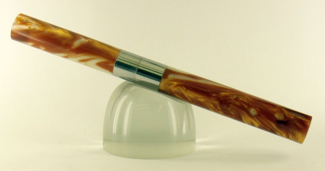

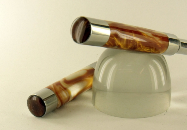

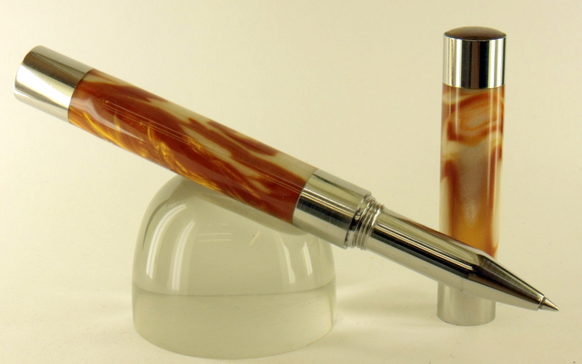

Quick fix?
First, apologies for bumping my own thread. :rolleyes:
Here's what I did to fix it. I was going to make closed ended finials from SS but that would have made them a bit too unbalanced so I simply turned two thin walled stainless sleeves and then a matching tenon on the pen and cap. Fortunately both the original closed ends where slightly thicker than the centre bands so it was a simple case of sanding back the blank to meet the sleeves. :biggrin: I think it looks better now even if the see through blank wasn't a problem. The ends don't look quite as dark as in the pics.
Thanks Ed !!:wink:

I thought the first pictures in the thread looked pretty nice. I think the revised ends make the pen extremely nice. I really prefer the SS ends completely.
Sandy.
