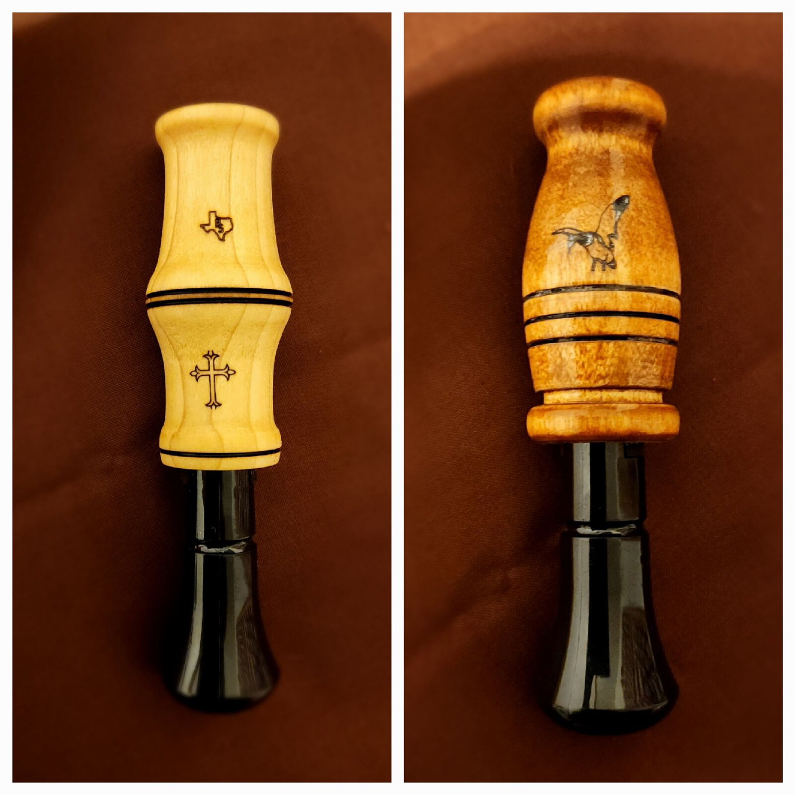

Well here are my first to practice duck calls. My designs kind of changed along the way as I'm turning popular wood. Very light and brittle. Lol I was using my Mt2 drill chuck to hold the mandrel which worked ok for this light wood. I started another with african blackwood but that wood was so hard my drill chuck kept loosening up. So now I'm waiting to get a collet chuck set before I go any further. Nothing like catching a drill chuck at 2000 rpms before it hits the ground. Lol All is good. Plus I need to get my CA process down again. The lighter one is coated with beeswax and a coat of Renaissance wax. The darker one I stained and attempted to CA. I also had to do a little laser work for decoration.

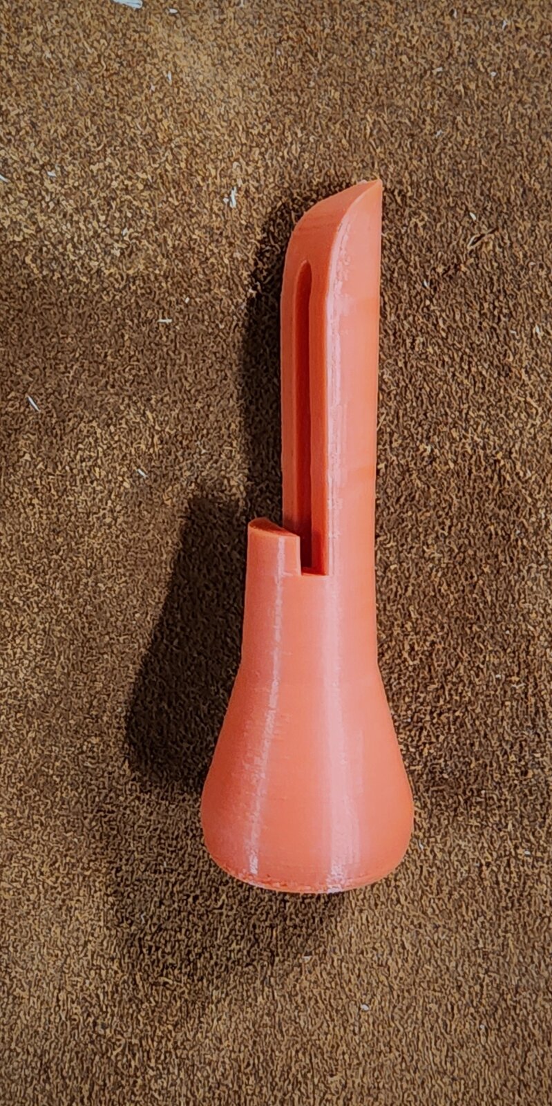

Ya, I use to hunt ducks a long time ago. I use to use my uncles call. Hardly remember it anymore. I've looked at echos reed kits as I want to learn how to make the inserts also. Was also thinking the same thing about buying one. I did print out an insert on my 3d printer for a model to make wooden ones.

these look great, I love the laser engraving too. Please keep posting updates.
Your comment on the shape of the call "ring" true with me but there are also only so many shapes. Maybe grab all your calls and see which parts of them you like and dont like
