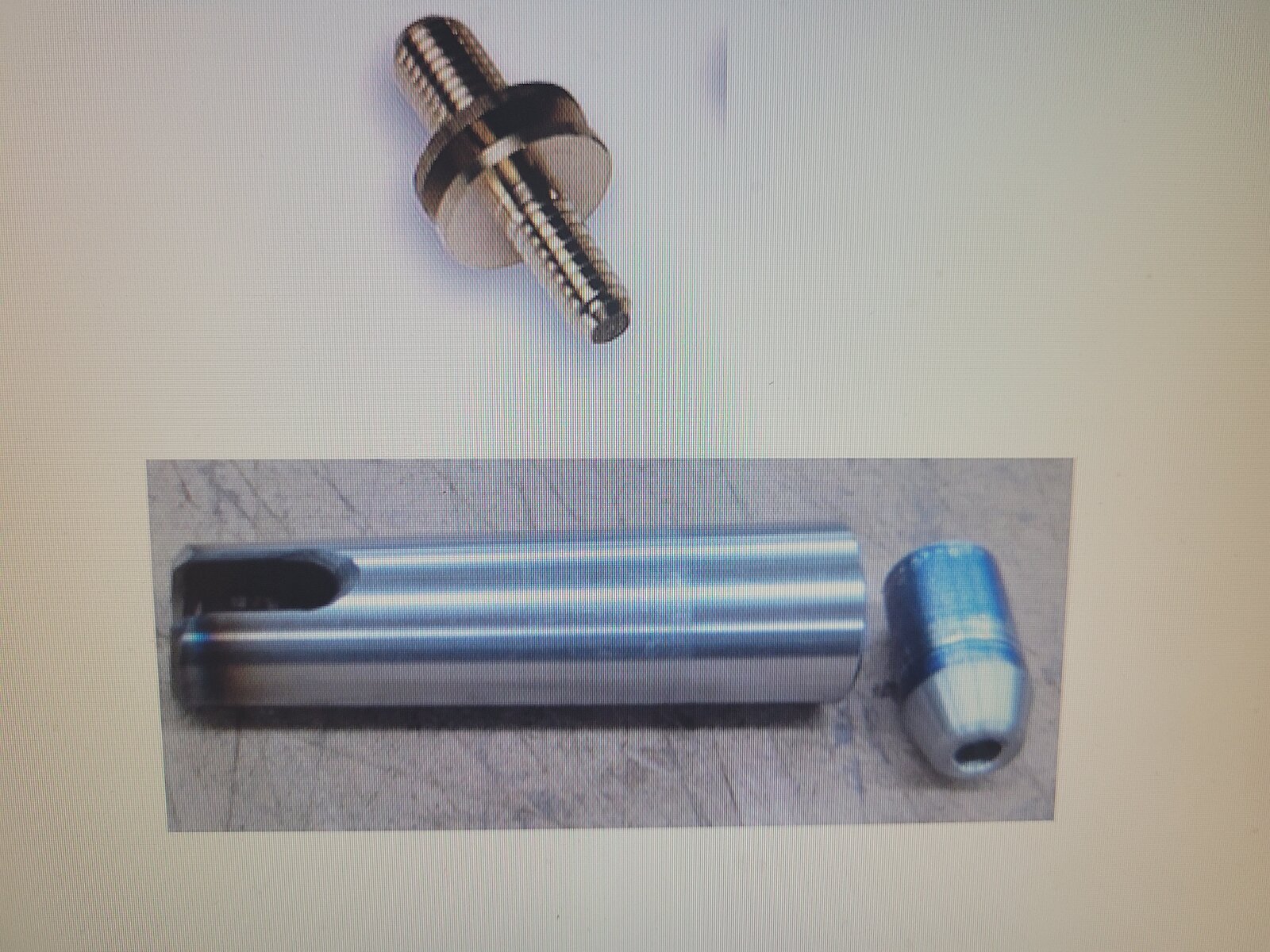

I have been planning and preparing to turn a 2 piece walking stick with a cane coupler as pictured below. In my searches, it seems like a big issue is centering the coupler in the wood. I had a thought to install the couplers centered in the ends of the square walking stick halves first.
Then I would then clamp the opposite end in the chuck and use the live center point in the female side of the coupler and turn the wood to match the coupler, using the coupler as a bushing.
For the male side of the coupler, I was thinking of making a custom MT2 insert for my Nova live center that looks like the mandrel saver that Rick Herrell made for me, pic below.

Louie, thanks for the detailed reply. I have a Jet 1014 with the bed extension. I can fit a spindle around 36" long between centers. I recently bought a steady rest so I think I can easily turn a walking stick half about 30" long, which is longer than I need. I am wanting a longer walking stick, and not really a cane. I have a brass hame for the topper. It could turn out to be too heavy and clumsy to haul around. Time will tell.
I plan to turn each half, tapering from the cane top to the top cane coupler, and from the bottom to the lower cane coupler. If it does not work out, the process should be a good learning experience. I bought a piece of 6/4 hickory and I will cut into square pieces the length of the board and then maybe cut the corners off before going to the lathe.
