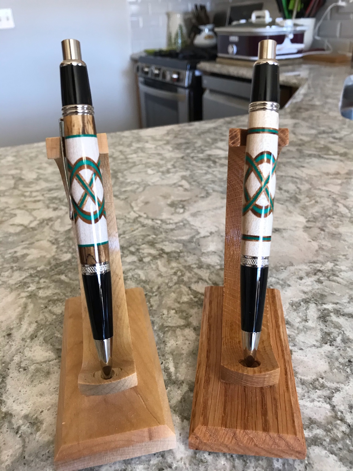

At a few shows people have specifically asked for click pens. I thought I better add some to my offerings. I was going to offer the edc dura-click, but that little extension on the ink refill caused me to double think that one. Then they came out with the Sierra super click using the same higher quality click mechanism so that's the one I chose to offer. These are my first two and I think I made the right choice.

Thanks Mark. On these two I changed the order that I cut knots. After the first cut is done, glued and sanded back down, I made the second cut on the opposite side. This is going to be new method, I think the knot looks a little better. No pen buyer will ever even notice, but a pen maker might[emoji846]

I like what you have done with these, Ken. . Very nice, indeed !!!
And I am going to differ from Alan in expressing my preference for the pen on the left ... with the brown wood-grain "barrel caps" :) !

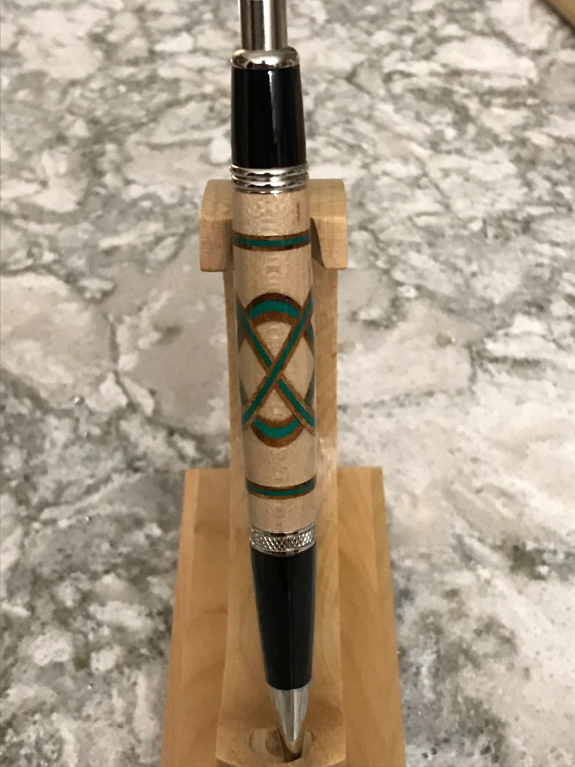

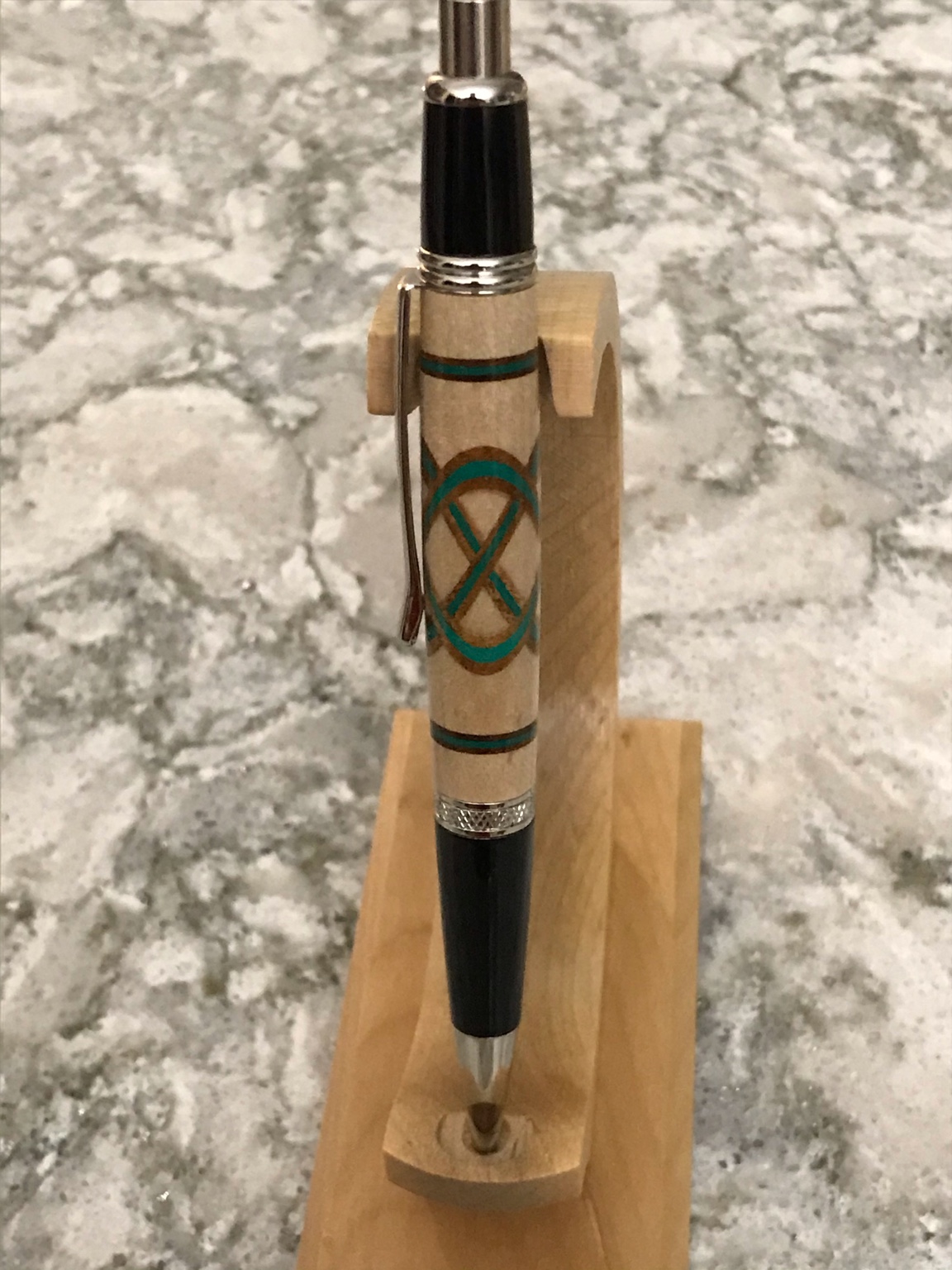

Ken can you spin one of the pens around and shoot another photo?? Doesn't matter which one. I do know eaxtly what you are talking about and if my thoughts are correct I have a suggestion for you.
OK here is my thoughts because you said you will change the sequence of cutting. Just about everyone who has done these were told to set the cuts up opposite. if you turn the blank 180 degrees it will mimic if you change the sequence of cutting. In other words when you mark the blank you were told to mark 1 opposite 2 and 3 opposite 4. So If you cut 1 first and then cut 2 second it does not matter if you cut 3 first and 4 second. All it does is turn the knot around so that the over and under is different. Try cutting the blank in order and mark the side 1-2-3-4 right in a row and see what happens. and compare. Or maybe you are doing something totally different than I stand corrected.
