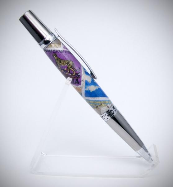

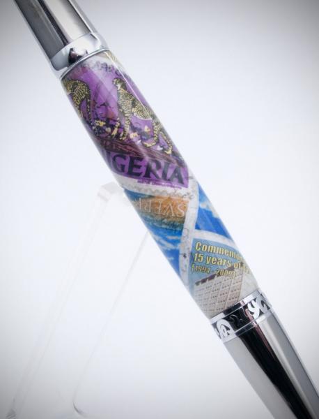

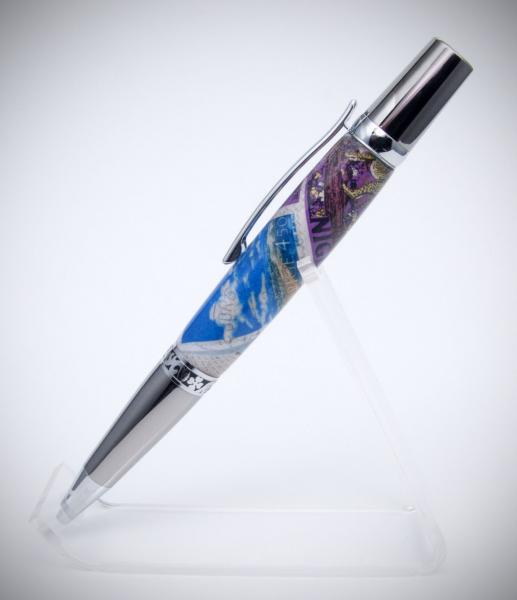

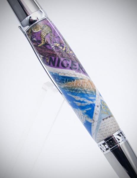

Hi there,
Following on from my thread about making these stamp blanks, I finally turned it today. This one is the second attempt as the first one (test piece) chipped out to bad on the ends. I went a little easier on the next one and here,s the result. I have just poured 2 more with more interesting and colorful stamps on. C&C welcome please.
Rich

Stamps are fun, been doing them for some time now. Still learn something new with every stamp tried(mostly which will shrink and which won't)....
Here's a tip....after you square the ends, apply some thin CA to keep water from getting between the stamp and the PR(for everyone else looking, I think you must know already-cause I don't see any 'clouding' on yours).
Colorful, fun, and interesting....all at the same time!!
Scott (could it be mailed now) B
