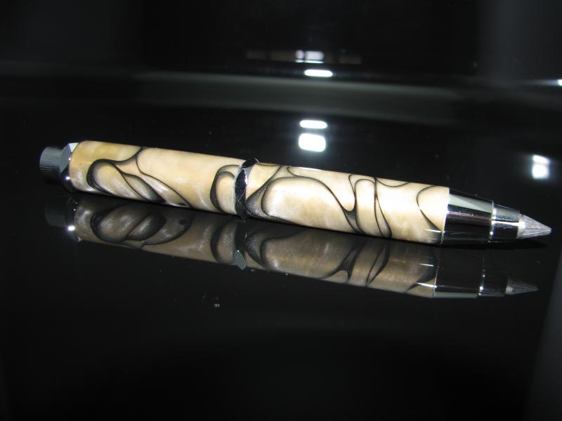

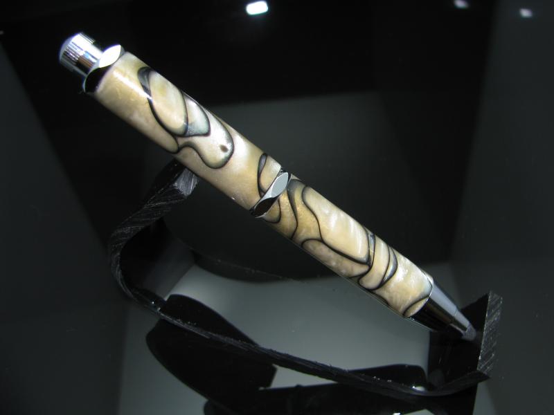

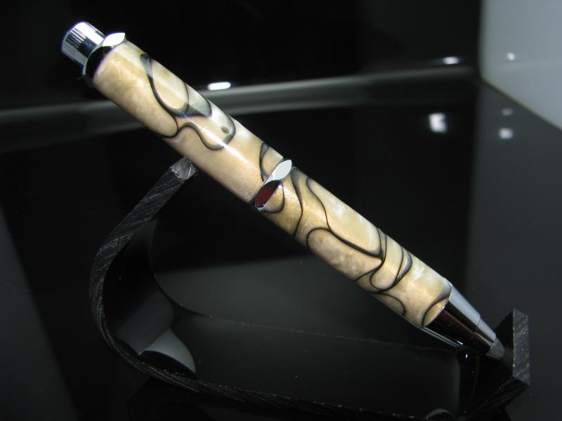

Well I finally got around to trying a new kit.
Smokey Pearl, on a Chrome Sketch/Shop Pencil.
I am pleased with the results except for one thing. After taking the photos I retracted the lead and went to retract it and it wont come out. I have tried everything minus taking the kit apart and I would really like to avoid that. Has anyone else had this issue? and is it fixable?
PROBLEM FIXED!
Hope the photos are improving. I am still playing with alot of options and built a light tent. (but thats a topic for another place).

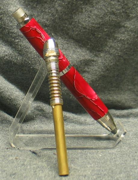

Larry, I've had the same trouble threading in the pencil/nib mechanism. I try to avoid using these techniques:
  1. Sacrifice a mechanism and grind flats on either side so you can get leverage to use this mechanism as a poor man's tap to ensure smooth threading of your good nib.
  2. Use this same mechanism as a holder if you paint tubes -- prevents paint gumming the threads -- I use spray paint for tubes and clean the sacrificial mechanism with acetone soon after painting to keep it reasonably clean.
  3. Spread epoxy or CA on the tube only after positioning the thread end of the tube in the blank (very end is "dry" but no problems for me so far with tube coming out) -- minimizes chance glue gums the threads. After milling/squaring the end, carefully seal any gaps between tube and blank on this threaded end with some medium CA and re-mill -- otherwise you can get dark sanding gunk seeping into that end if you wet-sand -- particularly with lighter color acrylic/PR blanks (minimize this problem by reverse painting these blanks).
Here's the one I use:
