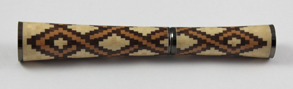

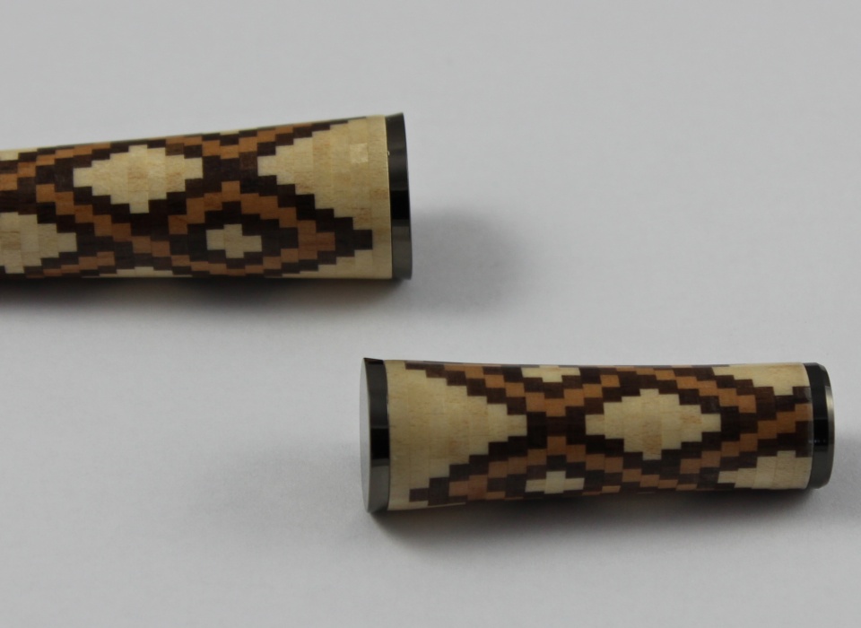

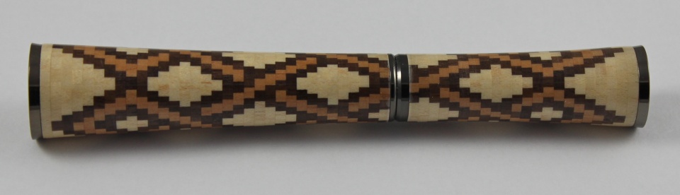

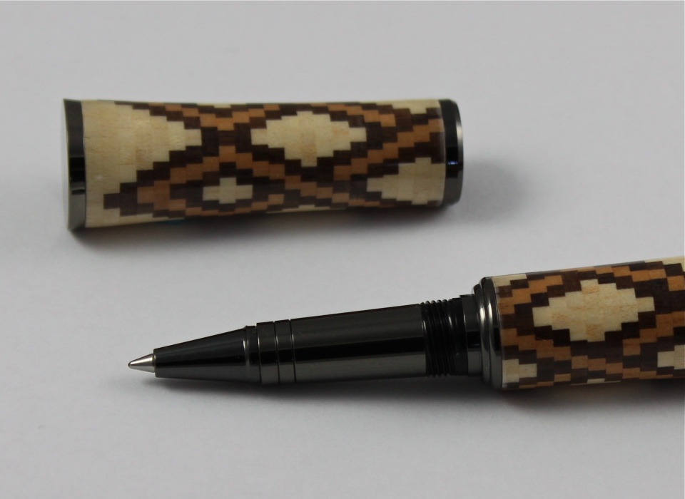

Thanks to everyone that voted for my pen. Also, thanks to Jonathan Brooks for running this contest. And to all the vendors who donated prizes.
I was really surprised to see i received first place.
I have had the idea for this pen in my head for a couple of years. When I seen the contest coming up, I thought it would be a good time to do it.
There are a total of 55 rings, with 21 pieces in each ring. Each ring is about .060" thick. For a total of 1,155 pieces of cherry, maple, and walnut. I used a CA finish on it.

I dont normally comment on kit pens unless they are impressive, they just dont do it for me.....that being said, i am very impressed with the time and effort and result that you got out of this pen! The thing that most impresses me, that some might not even notice, is your perfection with keeping the basket weave pattern. What i mean is the overlapping and underlapping pattern, as you would have if you were actually weaving a basket. Just glancing at it, one might just see X's across the pen, until you look closely and see that they are intertwined!!:eek: This took some real thought ( 2 years!!:biggrin: ) and was well worth the wait! Your other pen, slimeline i believe, was beautiful as well! Great job on these...you are a master segmenter!:biggrin:

I think that has to be the most accurate segmenting I have ever seen. Just amazing. Like Justin said, your other pen was also fantastic.
I'd love to figure out your process of maintaining the accuracy while you assemble it. :good:

John: That is a fantastic pen !! This kit is one of my most used bases because so much can be done with it!! I would like to see some more detailed photos of it, as these are a little on the dark side. Great craftsmanship !!! Jim S

Timebandit-- Glad to see you noticed the basket weave pattern. That is what made this quite a bit more complex to assemble. If any rings were off, it would really show up. Hoping to expand on this in the future.
Skiprat-- Not really any great secret to assembly. When I glue the staves up there is a small hole that runs down the center. I use that hole with 60 degree centers in the lathe to turn it round. Then I bore a hole down the center with pen jaws on the lathe. After that I slice rings off on the table saw. For this pen they were .060" thick. I number them as I cut them off, so if there is any variance, it will be lessened as I go. I them glue them up one at a time on a pen mandrel mounted in a drill chuck on the lathe using the tail stock for pressure.
