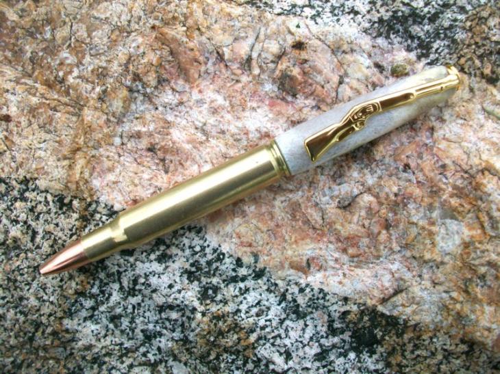

Here is my 1st 30.06 cartridge pen. It has an antler top with BLO/CA finish.
I tried one with the slimline nib and it just doesn't look right, IMHO! Needs the real deal!

I too would like to congradulate you on the first of many. These are good sellers. I too think these are so much more realistic than the kits and even these new ones. (Now I have just seen these from photos and have not been able to order any yet. ) Great job and thanks for showing.

Nice looking pen Bob. I also like the bullet nib versus kit. However, I must say that many folks, with no basis for comparison, are still very impressed with the cartridge pen and the kit nib. Keep up the good work.
