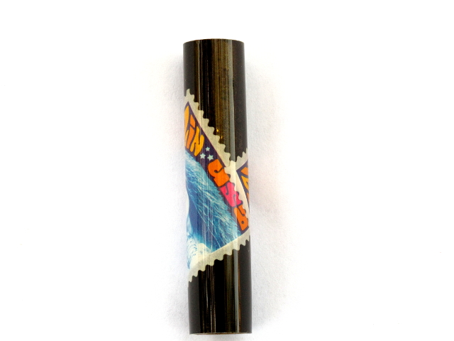

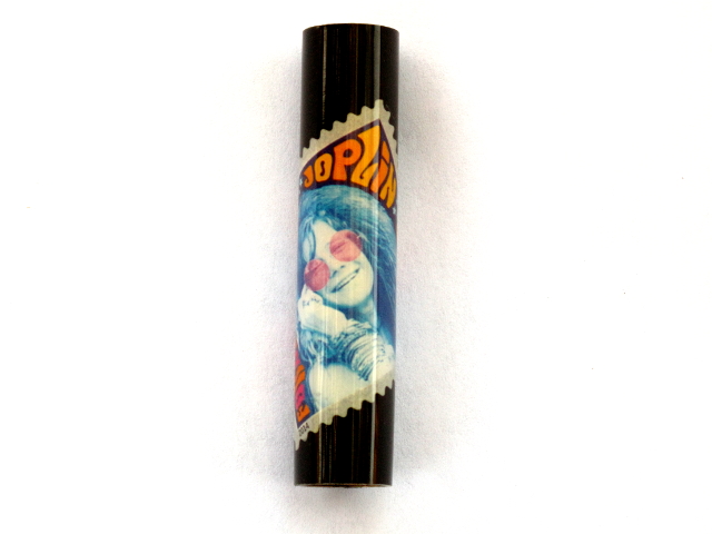

My first attempt. I made most of the rookie mistakes.
I didn't see it until after the casting, but I needed at least one more coat of black on the tube.(see back side of tube)
I wasn't able to do any thing about the little overlap on the back.
The tube is for a Mesa Click Pen kit.
My mold let a little of the PR leak out before setting and I was afraid I would not be able to turn out the flat, fortunately I was just able to. (I have made a new mold)
I had to go through the sanding from 1000 to 12000 twice before I was satisfied. Finally, I used an automotive polishing compound followed by a coat of wax.
I made my mold using "Amazing Mold Putty" and a length of 3/4" Delrin rod.
I used the rod to turn two plugs to cap the ends of the tube.
I used "Casting Craft Clear Polyester Casting Resin" for the casting.
I bought the stamp at the Post Office (DUH!).
I plan to keep the blank to remind me what to look for next time.
C&C welcome.

I fully agree. I was at the PO and saw this stamp on a poster and thought, ah! a pen blank.
I think I should have sealed the stamp too. The whites aren't quite as white as they were before casting. I am retired and like to try new things rather than go senile watching the boob tube!:biggrin:

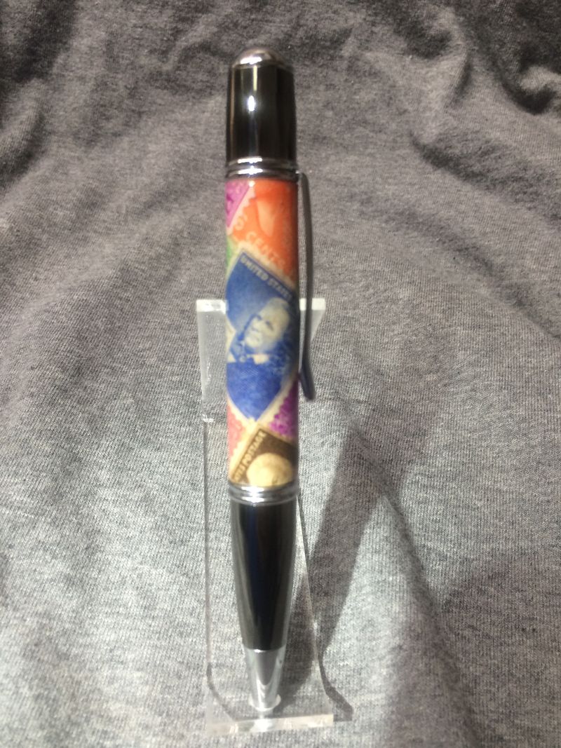

Here's an antique stamp Sierra that was my first try:
