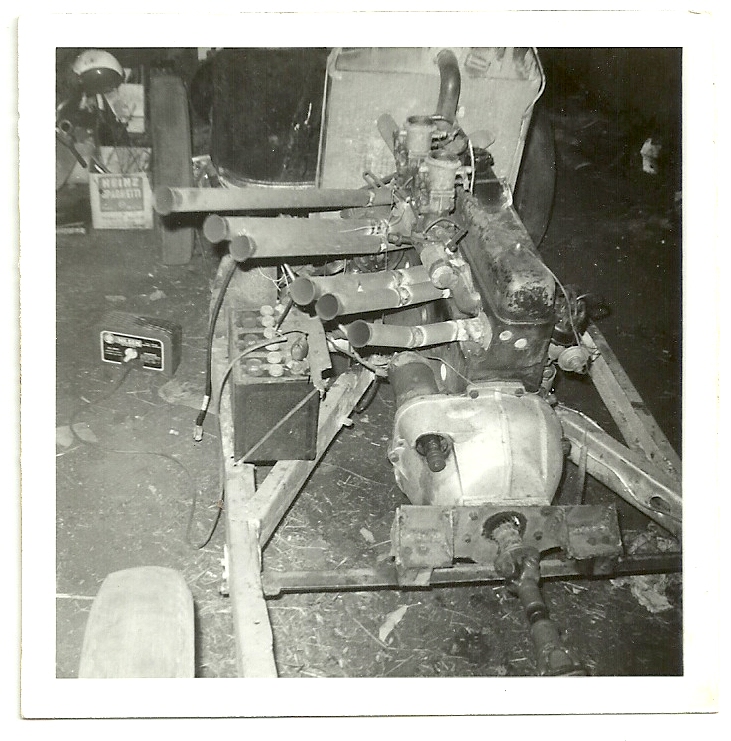

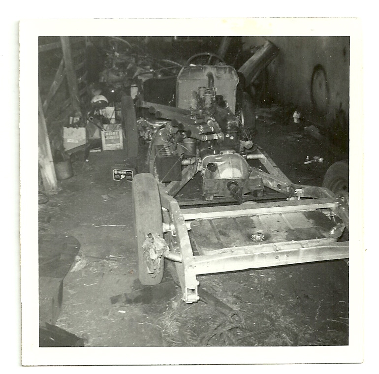

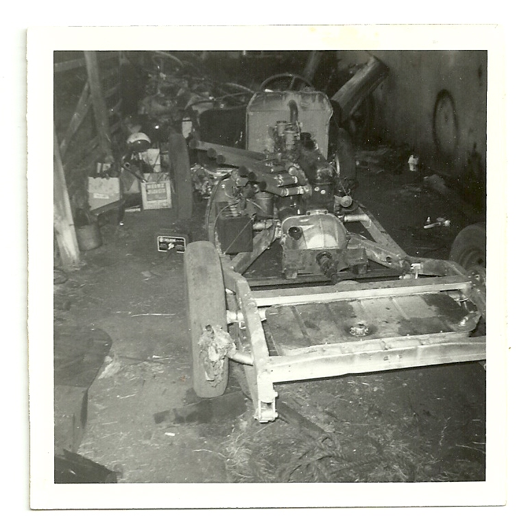

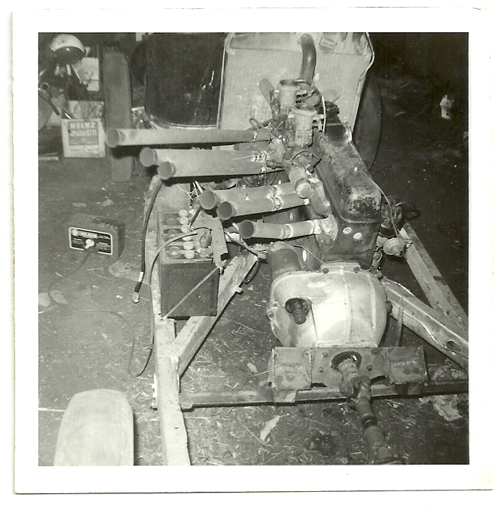

I recently saw a wooden Hot-Rod model posted on another Forum, such fantastic detail made it look soooo good. I thought why not share the "Machine" my younger brother and I built in our back shed/lean to.:smile:
I had a Vauxhall utility 6 cyl vehicle which I rolled over and wrecked.:redface:
We rescued the engine and gearbox for further use at a later date.
My brother got a small chassis and wheels from a mate and this became the foundation for this monster.
The engine would not fit in the proper place so we mounted it in the centre of the chassis. That looked good but created a bit of a problem elsewhere. There was now not enough room for the clutch and gearbox, we had to have a clutch so the answer was simple, cut the gearbox housing with a hacksaw and just leave the front part with the input shaft bearing. Not a problem.:biggrin:
Then we had 12 inches for the tailshaft, this was made by welding the universal joint to the input shaft end and a tube about 4 inches long between the two uni joints.:eek:
After mounting the radiator in front of the engine there was no room for the seats so they went in between the front wheels. No sweat. Only problem now was the controls, so we mounted the steering wheel and pedals onto the front cross member. Nice and safe. !!!!!!!!:eek:
NOW, after all this work we could not have a standard engine could we, so a trip to a wrecking yard produced two BIG carburettors, I think they came from trucks and we had to completely block one of the idle jets and the other one was reduced in size by inserting an oily wire, then soldering the hole and pulling the wire out. Worked a treat. Now we had to make a manifold, this took a bit of time using a piece of 2" galvanised water pipe, and some flat steel bar. Now for the NOISE, the exhaust was made with 6 different lengths of tube, each with a flare on the end. That worked very well.
The road tests were successful, although the Road Safety Authority would have had a meltdown if they had been confronted with this Machine.
We had some wild times on this, and it went like it was supposed to.
Happily we are still both alive, although I don't know how.:cool:
