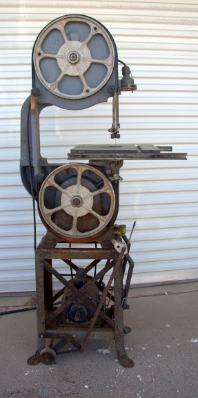

This picture was before I worked on her. Note the wooden blade guard! My brother found the wheel covers AFTER I bought another set. She was my grandfather's, and the first power saw he let me use when I was little. I'll take some AFTER pics and put them up.
Sharon.

OK, here is before and after. I added a riser kit, new hexagon guide post, new tires, new belt, new blade, band rollers, new tracking arm, wheel covers, new table pin, new thrust bearings and a new tension adjuster with BIG wheel. Got most of the parts from Iturra Designs.
