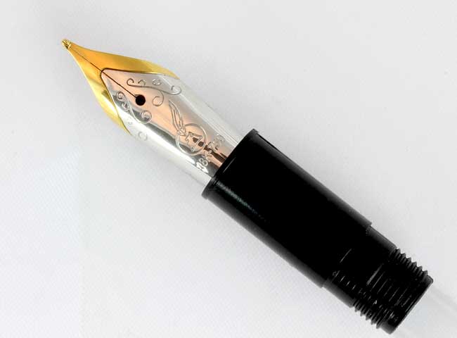

This would look awesome on a Lotus! 18K #6, Medium point
I can take it off of the triple.
(Sorry for the quick pic.)
