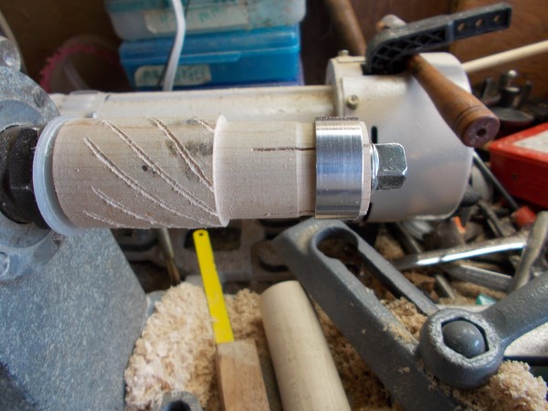

Here us a "ring mandrel" that threads on to my headstock. The square looking thing at the right end is a pipe plug. It's threads are tapered, so that as you screw it in, it spreads the 4 "fingers" of the collet like end of the "ring mandrel". The left end has been drilled and tapped to fit the 1-8 threads on my headstock. I suggest you use HDPE or other "plastic" to make this type of mandrel, the "fingers" are more consistent when moving out with the pipe plug.
You can make similar version that work as internal clamps, by using a hose clamp to bring the fingers to compress.
