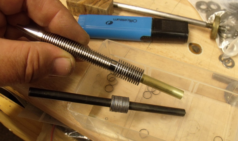

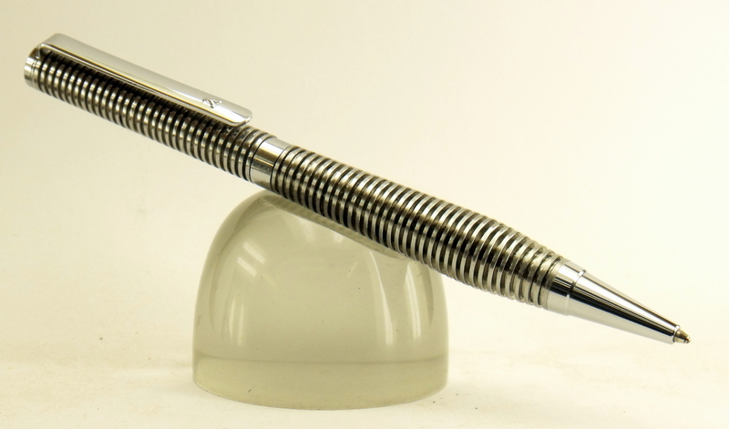

Just for fun.... a slimline made with about 140 stainless steel washers.
I drilled the 6mm washers to 6.8mm and turned half of them right down as far as I dared to make the 'spacers' and the rest became the 'shape'
Every now and then, I like to mess about with the good old slimline....:biggrin:

The third picture... Beautiful!

Skip, how did you hold each washer for machining? Did you make a special-purpose mandrel to hold them ?
Maybe you turned the spacer washers en-masse on a mandrel, then did the basic assembly and finally turned the shape-washers, also en-masse to the overall shape you wanted.

Mal, you got it. All ganged together to make the spacers, with a temporary male/female mandrel.
The washers were then stacked on the slimline tube, like in the first pic, and soaked in CA to stop them spinning while shaping. Once down to shape, I just used the square edge of a snap blade craft knife blade to remove the CA between the washers.
This could have been made on a wood lathe....:)
Oh....it weighs 31 grams. :), so not too heavy.

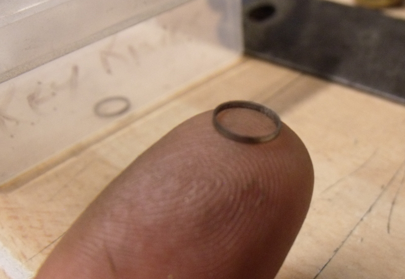

Did you end up measuring the wall thickness of the spacers? In that second picture it looks like you almost turned them down to nothing!
Wow!! I certainly didn't expect this pen to be so popular. Thank you!!:smile:
Derek, I didn't measure at the time, so I just checked now...the outside diameter of the spacers are 7.3mm and I drilled the hole out to 6.8mm, so that means the wall thickness is around 0.25mm, which I think is around 9 thou in old money.:wink:
