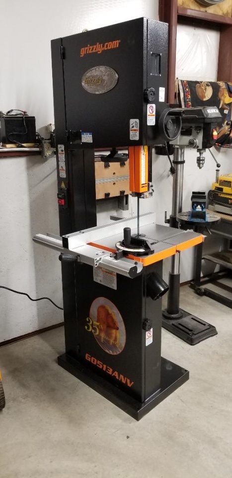

Well, out with the old and in with the new. Took a couple hours to get it setup. Not a whole lot of assembly but doing adjustments and all, it went very well. Next thing is to build a sled for it.

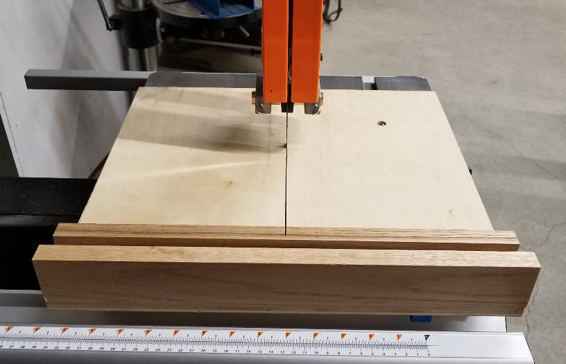

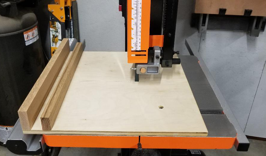

Finally got my sled made. Cuts thin. Lol
