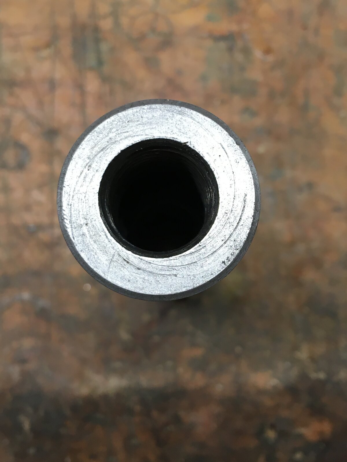

This lathe has been ok but I've had TONS of issues with the tailstock. Today I took it apart to clean it again and brought it out to the living room with me so I could do it and sit. It was at that angle where I noticed the hole is off center.
Does anyone know if they are usually like this, or is this why I've had so many issues with this thing? I think I know the answer but just wanted to make sure.

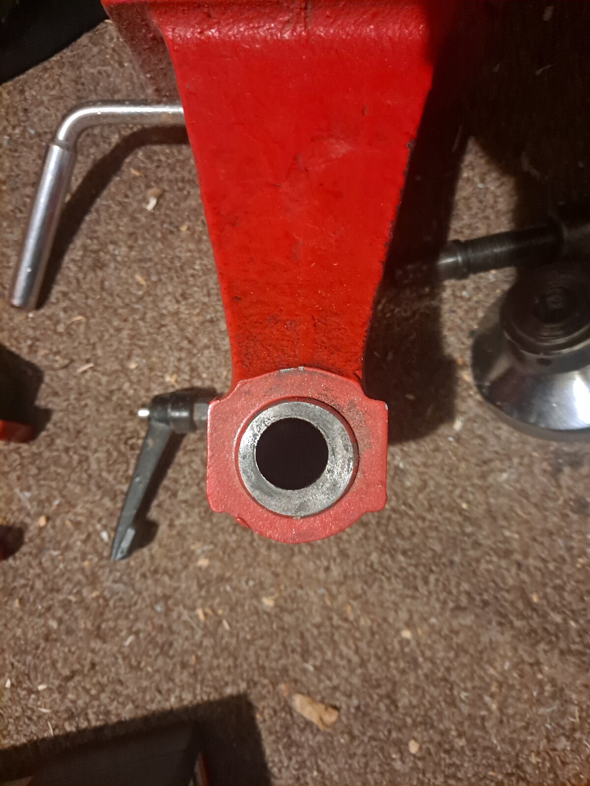

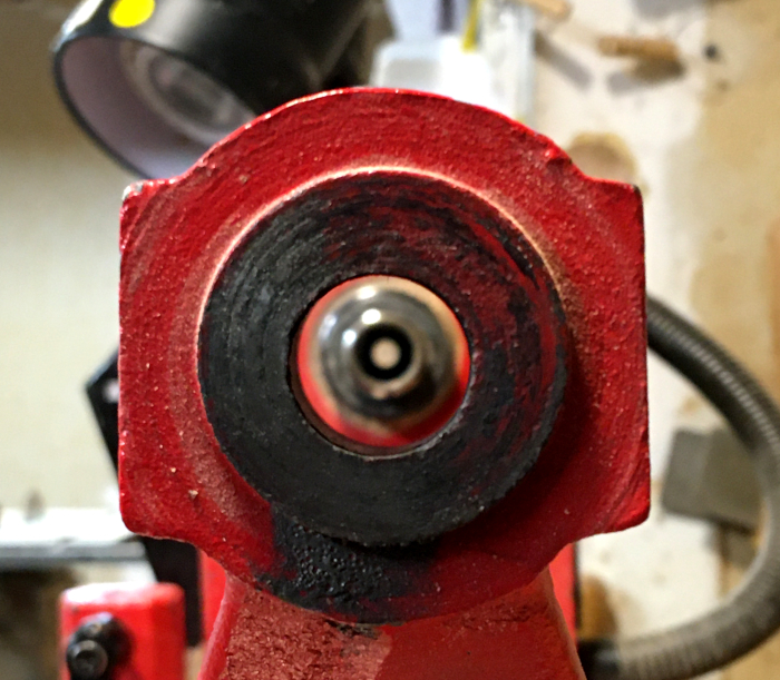

I grabbed a couple of pictures of what the tailstock ram and casting on my Turncrafter look like.
As you can see, the hole in the ram is perfectly centered, and when the ram is removed, you can see all the way through the matching bore in the headstock.
The ram doesn't rotate, and that hole receives the drive screw. The other end has the Morse taper, and as Rick says, it's probably machined from that end. But I agree with Hank that if the hole for the drive screw is not exactly centered on the the axis of rotation, tightening the handwheel will apply a force that will try to shift the ram off the turning axis (and in Joe's case, to about the 4-5 o-clock position). I suspect that the live center would compensate for that in normal turning, but when you mount a jacobs chuck for drilling, it's axis (and hence the axis of the drill bit) will align to the ram. The consequences could include stiff operation of the handwheel, and possible problems when drilling.
So as Hank said, I suggest getting on the phone with PSI. My experience with them has been outstanding, so I would expect them to jump on this problem immediately.

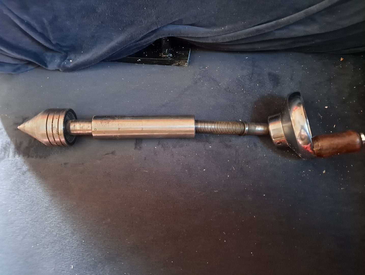

Yeah the issue its had is that it's super hard if not impossible at times to turn it out or in. Drilling and tightening. It has to stay clean and lubed every week. I am embarrassed it took so long to figure out the problem as I knew something was wrong but I attributed it to the threaded part inside binding up. I actually used the 1 from my old lathe which was smaller diameter when I got it new because of this but when the threads on the inside finally went bad I had to go back to the one that came with it. Here's a picture of what I am talking about.
I contacted psi this morning and they are sending me out a new tailstock housing as well as a U shaped sensor for the speed control.
