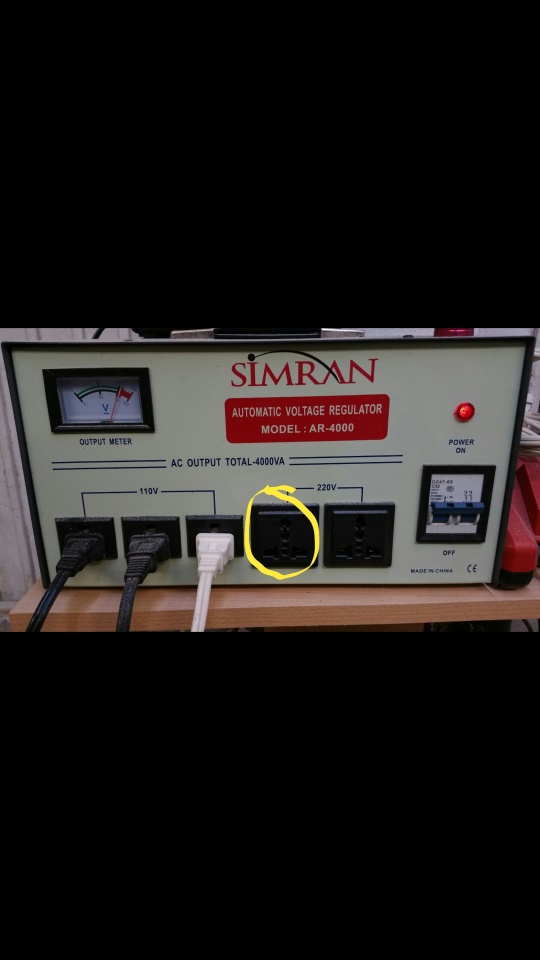

Brief synopsis, I live in Germany which has 220v power. I use a converter to power my lathe. It's a Jet 1014vsi. My friend accidently plugged the power into the wrong outlet on the power converter. It tripped the house breaker.
The lathe still turns on and runs. But it turns at only 1 speed and the dial for speed adjustment does nothing. It turns very fast now at that 1 speed. We took all the internals apart. No visual sign or smell that something got fried. It's a single phase motor
Any ideas on what to do?

I would guess that one or more of the components on the controller circuit board are shot. Replacing the controller board would make it an expensive mistake.
If you have a friend with skills in repairing electronic equipment you could have them look at the controller board. Maybe they could isolate the failed component and replace it for you.

The vs modules in the US are 110 nominal. Most/many of those rectifier boards can be set for either 110 or 220. Unless you have the skills or the friends to fix the existing board, you get to purchase a replacement. You have a really good shot at getting the 220 volt version (if still available). The 1014 was discontinued in the US a number of years back. I got mine on clearance 5+ years back.
If you are stuck with rebuild, jumper it for 220.
Something does not sound right. You should never be able to plug a 120V device into a 220V outlet. The configuration is different. Even in Germany. Did someone change the plug end of the lathe and if so why??? You should have just bought the match from the states for the outlet and wired that accordingly. You need to make a change here so this does not happen again or some other safe guard. I hope you do not have things set up like this. I maybe missing something here. But does not sound right. Even if you bought the lathe over there the 2 power chords have to be different.
I do agree with the others you probably fried a component in the circuit board and it was so quick you never smell it. It might be only the potentiameter but unless you have someone who knows what to look for do not mess with it. You can still adjust speeds with the belt.

I'm not familiar with that controller but if the board uses MOSFET output transistors there's a good chance you blew the MOSFETs. I think some other types of outputs have the same symptoms.
An easy and cheap fix for someone with basic electronic experience. Essentially just identifying the parts (heat sink mounted and probably obvious) and de soldering, removing and replacing with the same or higher rated ones, and re soldering. Any type of electronic repair shop should be able to do it for you if you lack skill yourself.

Would it be possible to make the lathe dual voltage? I'm in the military, and will most likely be going back to the States, as well as possibly being stationed overseas again

I hate to belaborer this but I do not see how this is possible. The blades on a 110plug are different size to fit in a 220 outlet. You can not plug a 220 plug in a 110 volt outlet so why can you do the opposite which is more deadly. I bet the blades on the 220V plug go horizontal and the the 110 go vertical. An American 110V plug are polarized in that one blade is larger than the other with a ground on a motor. Something is still wrong here.
Those aren't standard 220 volt sockets. If you look closely you can see where a 120 bolt plug could plug into it like many single plug converters. Dangerous to be sure but also convenient.
No I do not see how they are interchangeable from a USA stand point. Please explain how convenient it is to have someone electrocuted or something blows up because of stupidity. I can not see the the configuration of the outlets that well and not knowing what the 110 V plug end looks like. Look at the outlets. Unless that 110 volt chord and I highly doubt it for a lathe motor to not have a polarized plug then it is impossible to fit it into a 220 outlet without modifying it. Can you wire a 110v outlet to 220v, yes but it is illegal and not code. What they do in Germany I do not know. Years and I mean many years ago small appliances such as lamps did not have polarized caps but again I do not know what they do in Germany. If what you say is possible I hope the Good Lord protects you and anyone else that does this.
Again I do not know what the German chords look like and if they are interchangeable that is amazing. I understand countries abroad have different power sources and set ups such as different cycles and voltages but for safety sake there should be safe guards to prevent things like this from happening.

This is the heart of the problem in this instance: the SIMRAN power converter shown earlier has three '110V outlets for 2 or 3 pin USA plugs' and 'universal outlets at 220 v to accept plugs from most countries'. This description is misleading.
First, the 110v outlets appear to be similar to NEMA-1-15 receptacles except that they appear be able to accept round pins in addition to flat blades. I suspect that these are actually the BS 4573 (UK shaver) receptacle that are designed for 110-120v. electric shavers and toothbrushes.
Second, the 'universal outlet' does not conform to the standards that apply in any country, but does allow standard plugs from any country to be plugged into it. The use of a 'universal outlet' means that the power converter can be used with 220 or 230v appliances from any country - that's a good thing since there are multiple standard 220-230v plugs. But the bad thing is that there is an expectation that the user will understand the difference between 110-120v appliances, and 220-230v appliances, and will choose the correct receptacle.
So the core problem here is that the power converter was manufactured in China for universal application anywhere in the world, and was designed on the assumption that the end user would know what he was doing. Which means that the cause of this problem was operator error, and not some kind of egregious design flaw.
Assuming the manufacturer provided sufficient information to the buyer - a manufacturer of any universal electrical device should not assume that everybody in the world will be familiar with all of the electrical codes where it might be used and should have sufficient warnings to inform most users.
