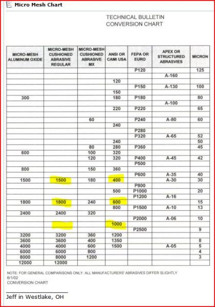

If you DO find it, you should skip the first three micromesh pads, as you'd
be going backwards.

So 1000 grit sandpaper (or Abranet) is not the same as 1000 grit MicroMesh?
(I haven't seen 1000 grit MM but just trying to compare apples to apples.)
Correct. Many of the materials have their own scales, which makes it a
bit more confusing for us. Lyle posted the chart.. I'd keep that tacked up
somewhere because it is easy to lose track and step backwards. And to
confuzzle things a bit more, many of the polishing compounds we use will
fit into that chart SOMEWHERE .. but they don't use the same scale either,
and we'll end up going backwards again.
