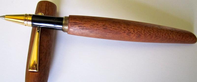

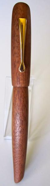

when I was a young man (approx 8-10) my grandfather thought it time that I learned something about working with wood.The lessons were not fun as he was teaching me to work not play with wood,The thinking was later I found out that if things went bad on any level I could always build cabinets or something.
(He did quite well making liquor cabinets that looked like record player cabinets of the prohibition days)
Here are some of his techniques.
to get the blank round,find a heavy glass jar with alot of curves in it,smash it!
look thru the larger pieces of glass for a piece that closes matches the radius that you are looking for,start scraping.
*note.I did cheat and drill and tube blanks prior to this step.
When the shape is about as far as the "glass plane" can get it either find a tighter radius in the pile or break a smaller jar.
Once the desired shape is approximated than a dowel is inserted in the blank and a sponge (old time sanding block I would guess )is wrapped in sand paper I started at a buck and went up to 1000.
shaping the top and bottom are tricky so I wrapped a piece of masking tape around the blank to try and keep the dome and tail as uniform as possible
finishing was a matter of BLO and Butchers floor wax.
I know by today's standards the "glass plane technique" sounds crazy but I have run across some old timers that were very as a matter of fact about it and thought only an idiot didn't know about it.
Grab some gloves(which was unheard of when I learned it ) the type that won't let the glass slip in your hand and give it a try,if nothing else your concentrating so hard on not cutting yourself you don't even think about the days problems
Mark

PS: So, is that a pen you made by glass scraping...??? That is a lot a fine scraping in there, well done.
Cheers
George

Yes George it is,
and I must say ( with a certain grin ) that the BLO/floor wax combo finish was chosen
as a result of your last critique. I was taught at a young age that simple finishes are
are the easiest to repair.I had forgotten that simple rule,(WOW THAT HURT )
I chose the chestnut because it is quite workable with this technique.
Can you imagine the looks you would get today handing a young boy a razor
sharp piece of anything and telling him "here scrape the devil out of that and don't get blood on it"
Hope all is wel
Mark

I remember as a young teenager, my grandfather had to replace a claw foot on their pedestal dining room table, and used this technique to shape the entire foot. Even though he had full access to my dad's workshop and tools, and full access to the wood shop at the senior citizen's center, he still opted for this method. To this day I am impressed with what he could do with so few tools.
Nice pen BTW, using this "old-aged" technique!

glass plane pen
Thanks
Just gave the pen to the teacher that lives across the street,
I built the pen to try an old technique that I had not used in over 30 years and put it on a lesser quality kit.( I did up grade the refill for her).

I'm not sure,I have not heard of it being used on a pen before,I would in the absence of a
drill press and having only a hand drill(like I said I cheated) drill the hole first and cut
the blank on line with the hole,I'm sure that a dowel inserted in the hole will give you the
truest or closest alignment of the hole to square up the blank with,
Jjartwood
Jan 30, 2011
697
Chicopee,Ma
The only real "trick if you will" is to cut the blank as close to the finished size as you are expecting to end up with it will save on the scraping, that includes different sizes for body and cap, also the tendency will be to try to almost finish the project with the glass
Don't, use the sand paper it goes pretty quickly.
