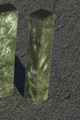

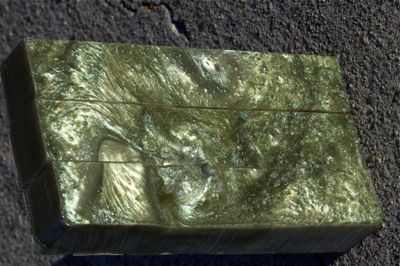

But there are times.... I had a customer that said "I want a Sage colored pen". After a lot more discussion what she really wanted was a pen to match this picture
Ok, where to buy a blank like that? I didn't find any. So I went to a casting-friend's house and we played until we came up with this
Now I have a very happy customer who can truly say she has a "one of a kind" pen.

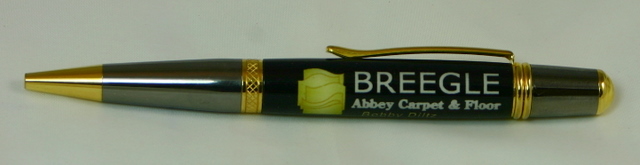

Whatt method did you use? Did you put a label directly onto the tube (it doesn't look like it) or did you add the label to a: clear, white, black alumilite blank? How many of what kind of coat did you use? CA - 6 coats?
DennisM
Apr 30, 2009
636
Northern Illinois
The label is added to the tube prior to casting. There are a few threads on it here, its basicly the same as the technique using stamps, forgot the term.
The general thing to watch for is air bubbles under the label, and certain glues break apart in the pr.
I did one as a trial using a piece of measureing tape from a table saw. It worked just my casting was flawed.. :)
