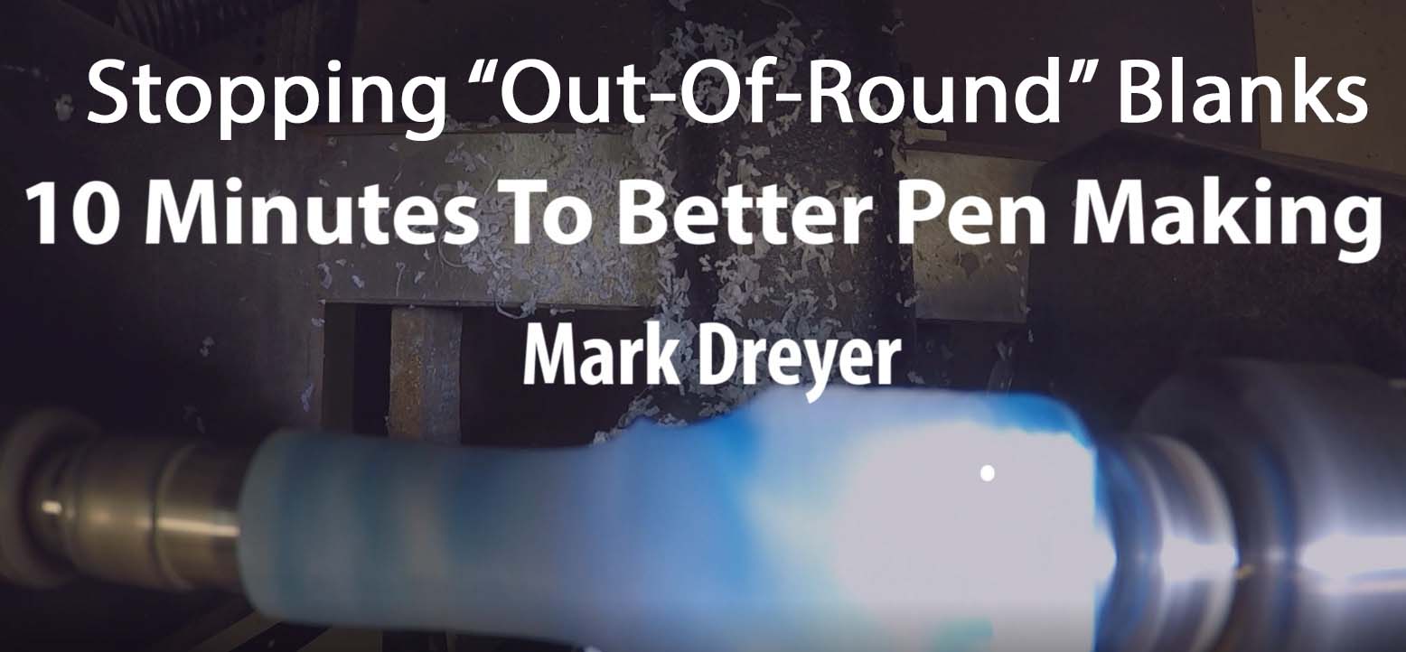

Just another quick video on "out of round". We look at two issues - mandrels and their progression over the years and the lathe itself. I show my preferred way.
Always looking for comments and feedback.
Click Here - 10 Minutes To Better Pen Making - No More Out-Of-Round Pens
