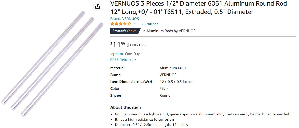

Mark, I think that there is aluminum tubing at the local big box store that is .5" OD and 16 ga. wall thickness. Would this be easier to use than the rod, as you wouldn't have to drill out as much?
Mike,
That is an excellent question - the first one that I did (and referenced in the video), I did use big box solid. If you try the aluminum tubing - please let me know how is works - the purpose of the channel is to facilitate these conversations and I always like when people let me know how it worked for them.
Here is what I used...
And thanks for watching.
