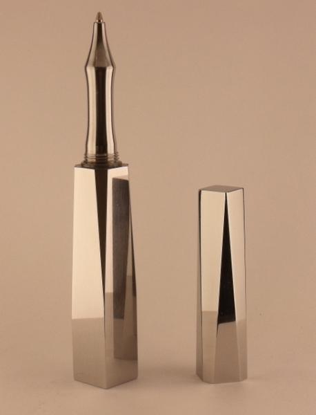

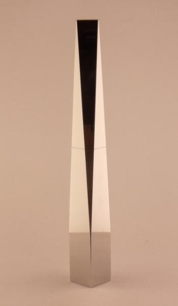

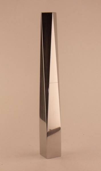

With my wife and I soon to visit USA, we've been researching places to visit. And with my passion for mechanics and big engineering feats, I couldn't help but get inspired not only by the structure but also the feelings of the new projects at Ground Zero.
This stainless steel pen is based on the iconic design of the Freedom Tower or, more correctly, 1 World Trade Center. I plan on seeing the real tower on our visit.
It wasn't particularly difficult to make but took a bit of head scratching to figure out how to hold it while I did the shaping on my lathe. Perhaps not too practical as a pen though
I'll do 2 WTC next.
I'm quite pleased and hope you like it too. Unfortunately it was too late for any of the bash contests, but now I've seen those entries, it wouldn't have stood a chance anyway!!:biggrin:

That is super awesome! Belongs in a print ad somewhere for sure! Always in admiration of your work, makes me do this :bulgy-eyes:
Hi Skip! Excellent work! And I ALMOST could not see the seam where the cap and body come together. Are you just that good, or did it just happen to work out that way?
Ans: You are just that good.
Steve Guzy
Steve as always great execution, great thought process and overall great looking pen. A pen like this is a trophy or a museum piece. It is not designed to be written with. I look forward to all the pens associated with TWTC.
Steve Guzy
Ha ha, not as good or clever as that. :smile:Alignment was done at the first stage of the making. I drilled and tapped the insides and put a temporary threaded section between the cap and body. The material was square to start. Because I used a 12 x 1mm thread it was easy enough to skim one surface and then give them a bit of a polish until all the sides aligned.
I then superglued the threaded section into the cap and body.
I then set up a vertical slide in my lathe and milled the tapering facets.
Thats why they now align perfectly.
Of course, a little heat got rid of the CA and I swapped the threaded section for a nib that I made. :biggrin:

Skip, just a thought but would it be more writer friendly to make the bottom the cap? Iregardless "Fantastic".
:biggrin:
This was an option, but I discounted it on two reasons. First was the asthetics when displayed open and the other was the angle of the edge.
Now that corner is greater than 90deg and isn't too uncomfortable to hold. If it was the other way round, the angle would be less than 90deg and feel a bit sharp, but perhaps a little lighter. :wink:
