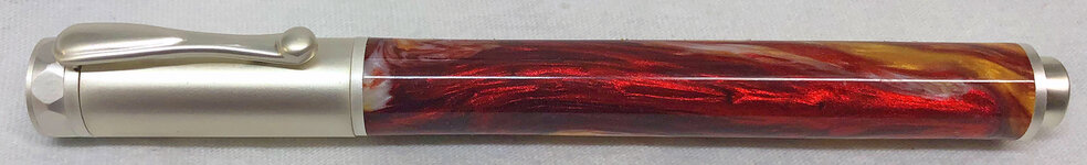

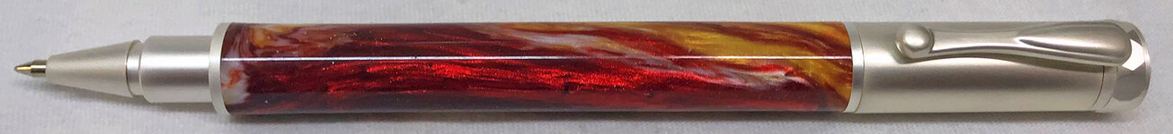

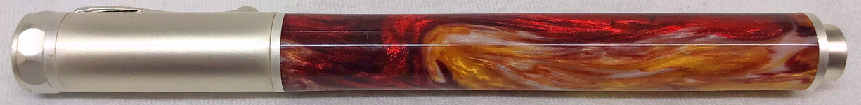

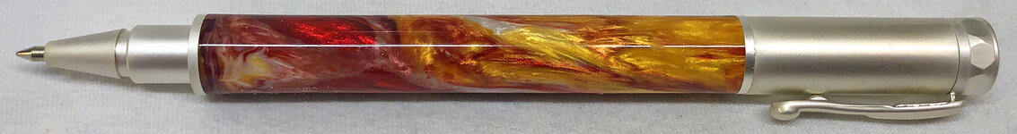

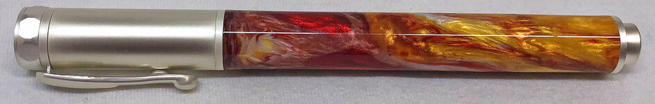

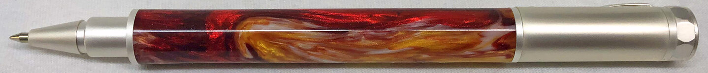

Greetings from Nebraska.
I used the shortest blank from my pour (blank #2) - it leaked out the bottom of my mold. Darios already named this batch - Koi. I think it is an excellent name as the blank is made from Red, Gold, and Pearl. The kit is a Eco Zen from Exotic Blanks with Satin Silver plating. I hope this blank is representative of the rest of the pour. It really has a lot of depth in the red and gold. And so the adventure continues....
Dave

Wonderful blank and amazing for your second pour. I am not familiar with the Eco Zen, does the point usually stick out that far?

So far all of the Eco Zen's that I have received from Exotic Blanks and the Magnetic kits from Crooked Mill have all had about the same ink extension. I tried a Pilot G2 ink refill which is what I usually use and those don't extend quite as far out. - Dave

Great color combo! I like how the reds and gold stuck to their own and slowly swirl around each other as the pen rotates.
What red Mica did you use? That looks really nice.
I used Alumilite Clear Slow with
- 33% Eye Candy Yamagata Red (Heaping 1/2 teaspoon in about 120 grams of resin)
- 33% Pearl Ex Brilliant Gold (Heaping 1/2 teaspoon in about 120 grams of resin)
- 34% Pearl Ex Micropearl (Heaping 1/2 teaspoon in about 120 grams of resin)
