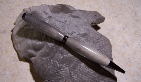

...same pen as previous picture, just a different angle.
.... I suppose I shouldve mentioned.... it is my first pen made from an acrylic cast I made, previously posted tubes... it is "Castin' Craft acrylic.. I blew out the tip of the tube while turning but thought about all of the posts that use CA as a finish on acrylic..figured I had nothing else to lose by trying an "on mandrel" repair with CA & accelerator.... looks like it worked to me so far! Learnin' ,learnin'!
