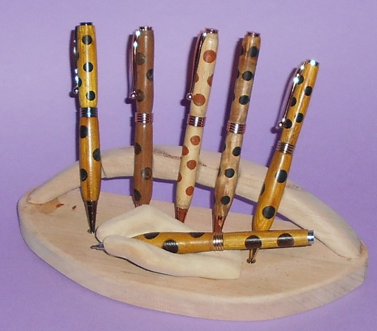

Being new to pen turning scene I thought I would have a go at adding dots to the pen blanks. After drilling the holes I filled them with Milliput and let it set for 24 hours before drilling the centre hole for the brass tube. Worked OK but
discovered that the Milliput took longer to set in softer wood Here are the first attempt. Cheers Bob C.
