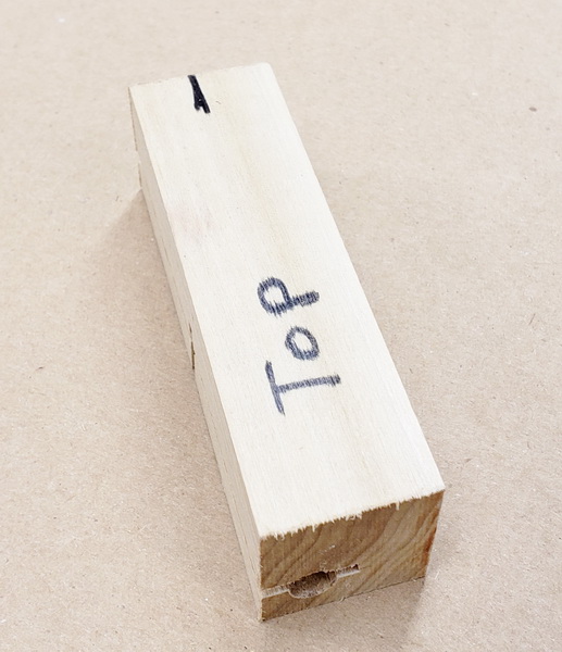

This is a small Brass Tubing cutter I made for my table saw. The hole is sized so the brass tube I want to cut is just a slip fit.
The Block clamps down with a hold down that keeps both parts of the tubing in place while they are cut.
The Table saw blade cuts the vertical kerf in the block.
