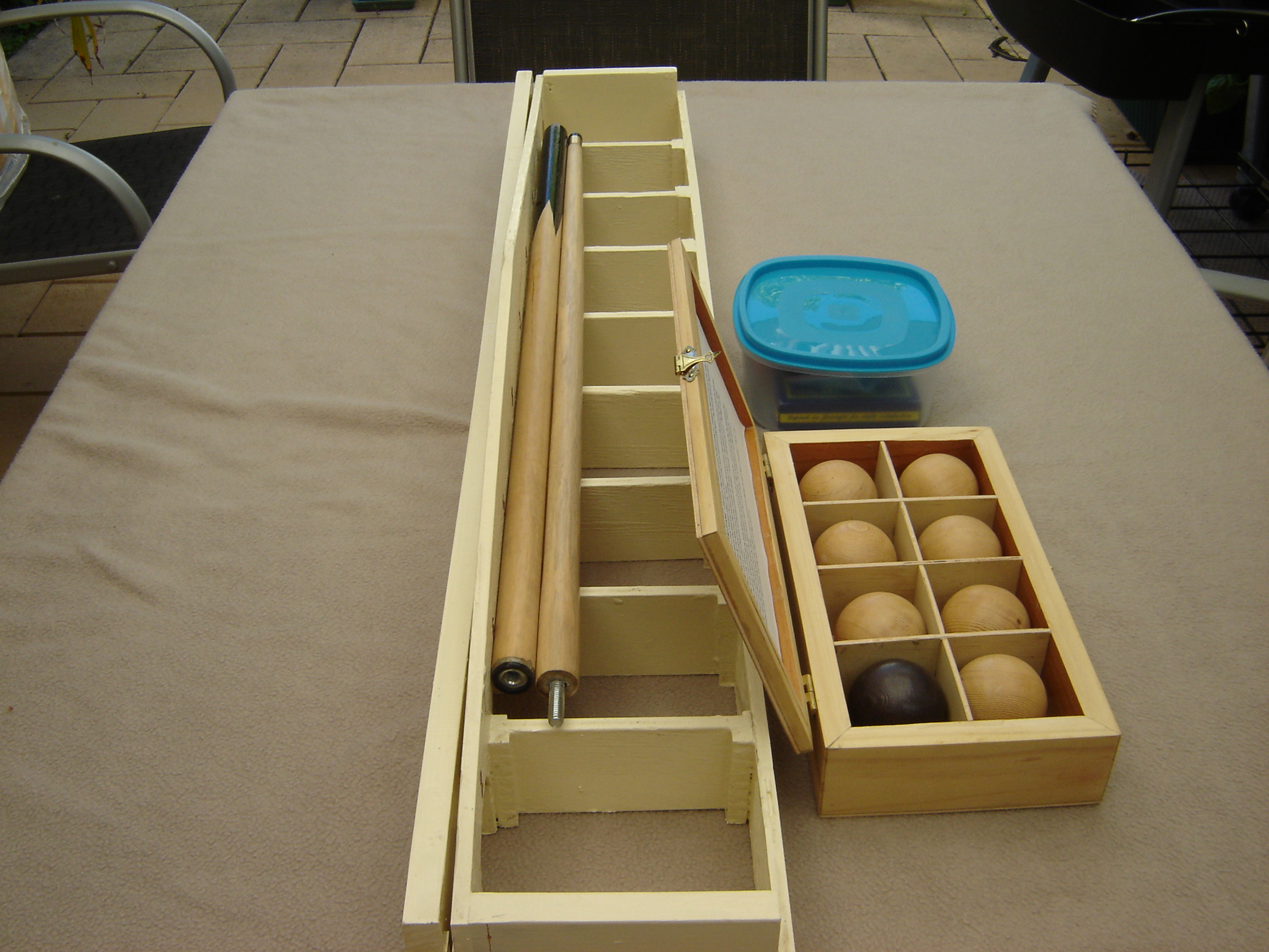

My Brother in Law, asked me if I would make a Bob's Set for his 9 year old Grandson.
The Balls I made by hand with no ball jig, but I did us a "Pipe Scraper" to true them up. I wanted 8 Balls, so with a couple of rejects and Spares I gave up at 10. :wink:
The Cue was made from a 1" dia Broom Handle, it was too long for my Lathe so I cut it in two and Turned both Halves, I fitted a Chair Leg "Screw and Threaded Plate" so that it could be rejoined. I bought a 12mm Ferrule and set of 5 threaded Cue Tips.
The Arches, and Pockets were made out of Plywood, and 1/2" pine boards.
Also to store the Balls, I made an Egg Crated Box and Lid, so hopefully the balls will not get lost, as he only has two spares, and I do not intend to make any more. :eek:
To round off the Task, I also procured a Box of 12 pieces of Cue Chalk.
So he should be off to a Great Start.
