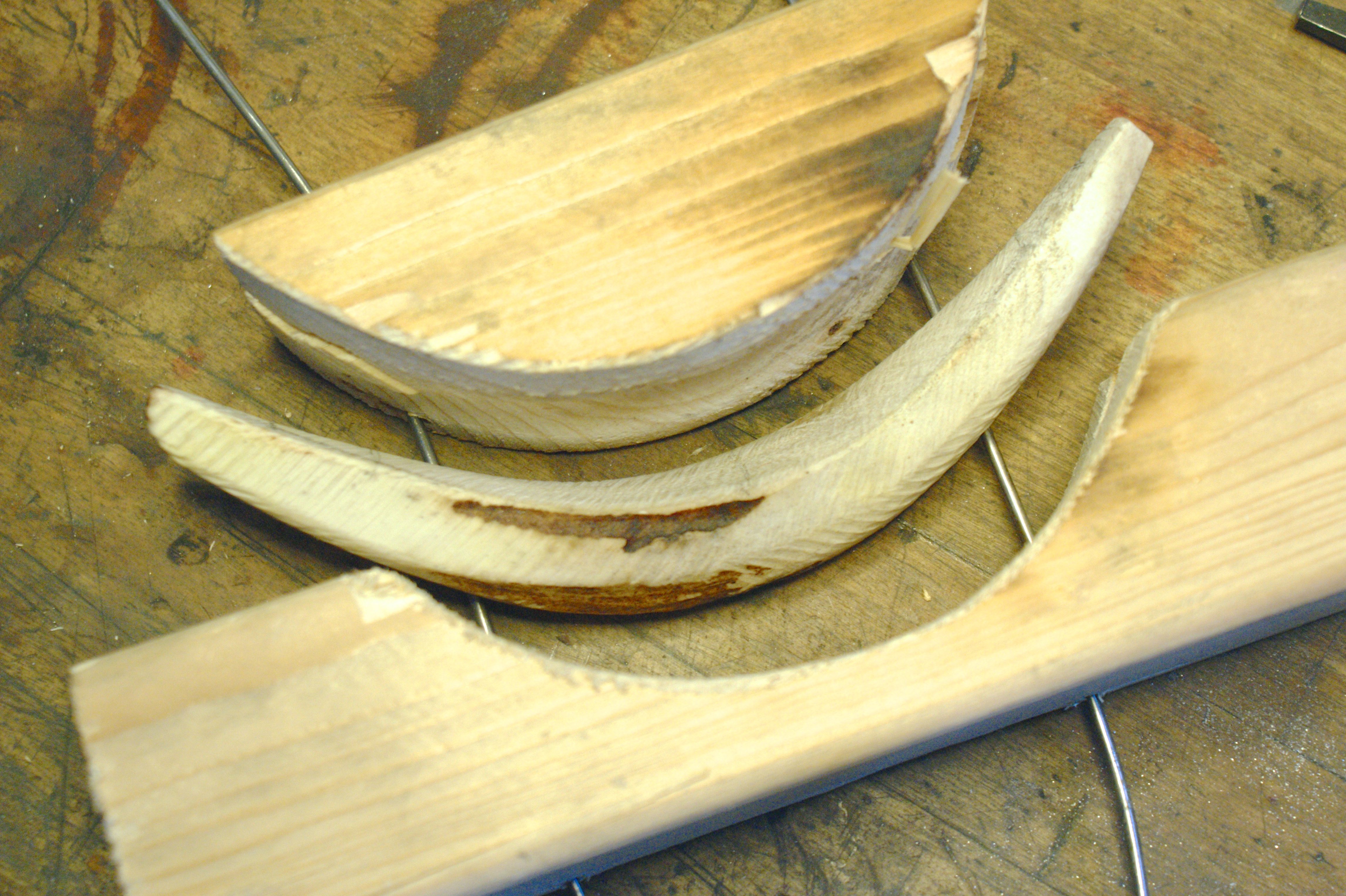

I don't know if I can find it now but I will look for a method of straightening curved antlers enough for pens. It involves boiling for a while and then straightening while still hot and wet. In a manner similar to bending wood.
Here is one link:
You can also use the tines to make slimline per if they are straight enough. I have made several of them. Also if the base pieces are large enough, them make nice bottle stoppers and handles for ice cream scoops and pizza cutter handles. Nice pens.
Here is one link:
I've tried the bending antler process with not real good results. I found it was easier to just get more antler.
