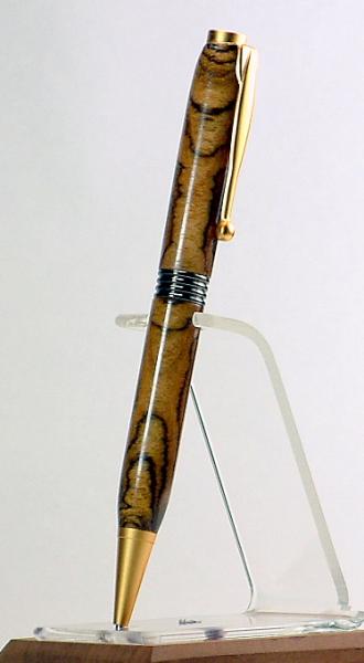

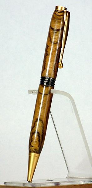

Hi Gl,
I turned my first Ziricote pen this week enclosed pic shows the finish I used CA or Super Glue common name the thin stuff applied with the lathe running full speed the CA applied from blue towel one coat then the next for four coats each coat straight after the last. Let it dry for a bit then quick spray with setting stuff. I always use a wax stick then put on polish off two coats.
Have success Peter.
