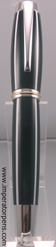

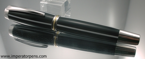

Segmenting with Byrnes Table Saw
Here is a pic of the first blank I finished into a pen that was made using my new Byrne Table saw. Nothing fancy but I think it looks sharp.
It is Black Knight Poly resin from Dawn with four white pickguard lines running the length of both barrels. I got them lined up pretty good when the pen is closed, but not perfect.
Instead of doing a true segment I simply squared the blank on the table saw and then set the fence so I would cut down the middle of each side of the blank. Rather than cut all the way through the blank I cut just deep enough to be inside the diameter of the smallest tube. The kerf of the small saw blade was exactly the width of the pickguard. I put a line of CA in the cut and inserted the pickguard.
Just curious if that is the way you advanced pen makers do this or do you cut all the way through the blank.
It was odd turning and sanding it. I was getting some vibrations I don't normally get. I hand sanded back and forth with the lathe off and concluded that it was from the pickguard. Although the pen is perfectly smooth throughout I think the pickguard is a tiny bit higher than the resin and that was what was causing the vibration.
Looking for any tips or suggestions that could help me continue to advance my pen making. Thanks.
You mean there were blanks that didn't make it into a pen :wink: :biggrin: Just kidding Peter. I have more blanks that didn't make it, than I have completed pens. It's part of the game and your completed pen looks great. Well done.
That is pretty similair to the way I make my this pen The only difference was I made all six cuts, then inserted the inlays and lastly smothered it with thin CA. The thin CA will wick into the smallest of joints. I know if I applied the CA first I would get the inlay stuck when it was half way into position.
I would guess that is caused by the inlay material being harder than the main pen blank. Once I started using a 1 1/4" Lacer skew all those vibration problems disappeared. The large skew looks pretty silly next to a little pen blank, but it works great. The guys in my local chapter tease me about my skew. They say I just show it to the pen blank and blank gets so nervous the wood starts to fall off. :)
Looking forward to seeing what you come up with next!

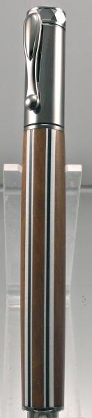

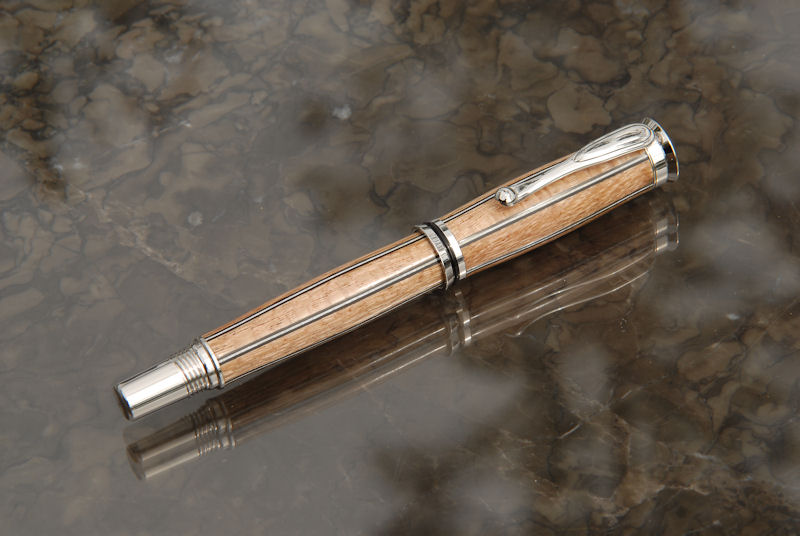

Zen Pen using byrnes tablesaw
Here is my next blank that I used for a pen. Several went in the scrap heap between the last one and this one, but not as many as the first try.
It is a zen pen (first one I made) with Rambutan wood and two pick guard inlays on two sides. I can't quite get the hang of two on all four sides. It seems that more often than not the dimensions are such that the second line on one side cuts into the line on the adjacent side.
There is a woodworkers source near me and they always have a lot of Rambutan cut offs for sale cheap that I can make into blanks. Not a very interesting grain, but it finishes up very nice and I think makes a good background for inlays and such.
I have been buying pickguard from some web site that sells to guitar makers. They don't have any really interesting layered ones, just some version of black/white.
If anyone knows where you can get flashy pickguard that is layered let me know. Like yellow, red and blue layered with white or just plain.
I'm sending this pen to my oldest sone who lives in Ft. Worth. A while back I made my grand daughter (age 3) a magic wand (was bored) out of a long piece of the Rambutan and segmented a pointy piece of antler on the end. I wrote a little story about it how a little girl in a village saved everyone from a dragon with the wand. My son says almost every nite she likes to hold the wand while he reads her the story right before she goes to sleep. So I thought he would like a pen with the same wood. Oh well, that's just how boring my life is, lol.
Thanks
Peter, it sounds like you are trying to make a pen with eight stripes. The method you are using is not working because the blade is not cutting towards the center of the blank, so when you turn the pen the sides of the inlay are being exposed instead of just the top of the inlay. Hope that made sense.
Try this. Prepare a blank with four inlays, one on each side, the same way you have been doing. Then make a jig/sled for you table saw that has a v shape on the front and back of the sled. Place the blank in the v's and make the cuts for the inlays. You are effectively rotating the blank 45 degrees to make that cut.
You will need to raise the blade a bit to account for the thickness of the sled as well as the fact that you are cutting through the "diagonal" of the square so the distance to the center of the blank is greater.
I don't know if your table saw has a miter slot or not. If it doesn't you can just run the the sled along the table saw fence. Make sure the blank sits securely in the v's and does not rock from side to side at all.
