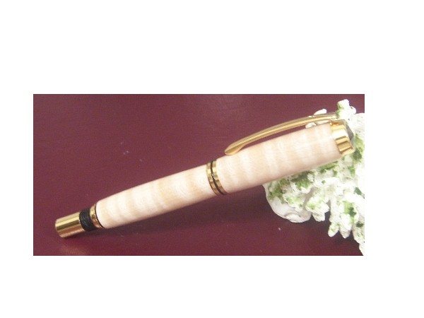

I just assembled a Jr Gents Pen (from Dario's group buy) made out of curly maple. I think it came out pretty good. Best of the 4 or 5 i tried with CA so far). The wood and finish came out pretty close to life as far as color goes, but for some reason, the gold looks like shiney copper. I have no clue why. As everyone here knows, I am photograhically challenged [:(]

What type of light did you use?
Once, I made some still pictures using a movie camera light for a light source. The pictures were of polished stainless steel, and they turned out to look like they were made from gold. It must have been the temperature of the light, of which I know nothing about.

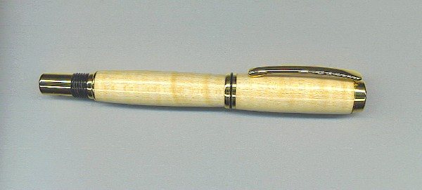

Bonefish, i took the picture in my kitchen with a kodak easyshare digital camera, the lighting consists of day light bulbs. They are pretty bright. I also had the flash on with this picture. i took a few with out the flash, but they were too dark. Maybe I can take them with out the flash, then use software to lighten them up. I also scanned the pen, you can see it below. I think I probably need to set up a tent or something and get a tripod, or use my 35mm camera, which would be a real pain. Whenever I scan, you can see it does tricks with the metal plating also.

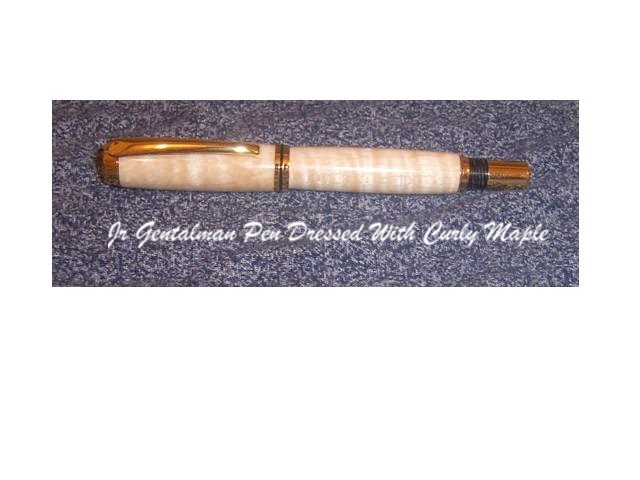

Ok...I am going nuts now and I am probably driving all you people crazy too. This Pic is without a flash, 600 watts of daylight bulb light and 600 watts of halogen light. It's pretty interesting how you can take three digital pictures, with different lighting and they all come out a lot different. I got to assume the blurriness is due to not having a tripod. Of course it could be the camera too. It can't possibly be due to my rock steady hands, can it? hahaha

Besides the different lighting that you used, all of us have different monitors from yours. Our color, brightness, and color settings can be different from yours. Add to that, all of these different brands and types add their own spin to the picture when it is put on the screen.
The bottom line is that you have no idea what we are seeing when you post a picture.

Russ is right. I made an Emperor the other day, the pic looked great on my computer, but now I am using the computer at work and it looks somehow different. Almost like it's a different Emperor.
I dunno, just looks so much darker than it does on my home monitor. What do you think?
